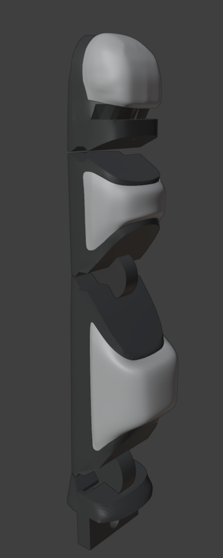

    Silicone injected components have been refactored.
    All holes for silicone injection have been moved up to prevent any leakage, that was causing cavities in the pads.
    Components updated:
    • Thumb phalanges
    • Thumb joints
    • Index phalanges
    • Index joints and inserts
  • Thumb Base Reinforced

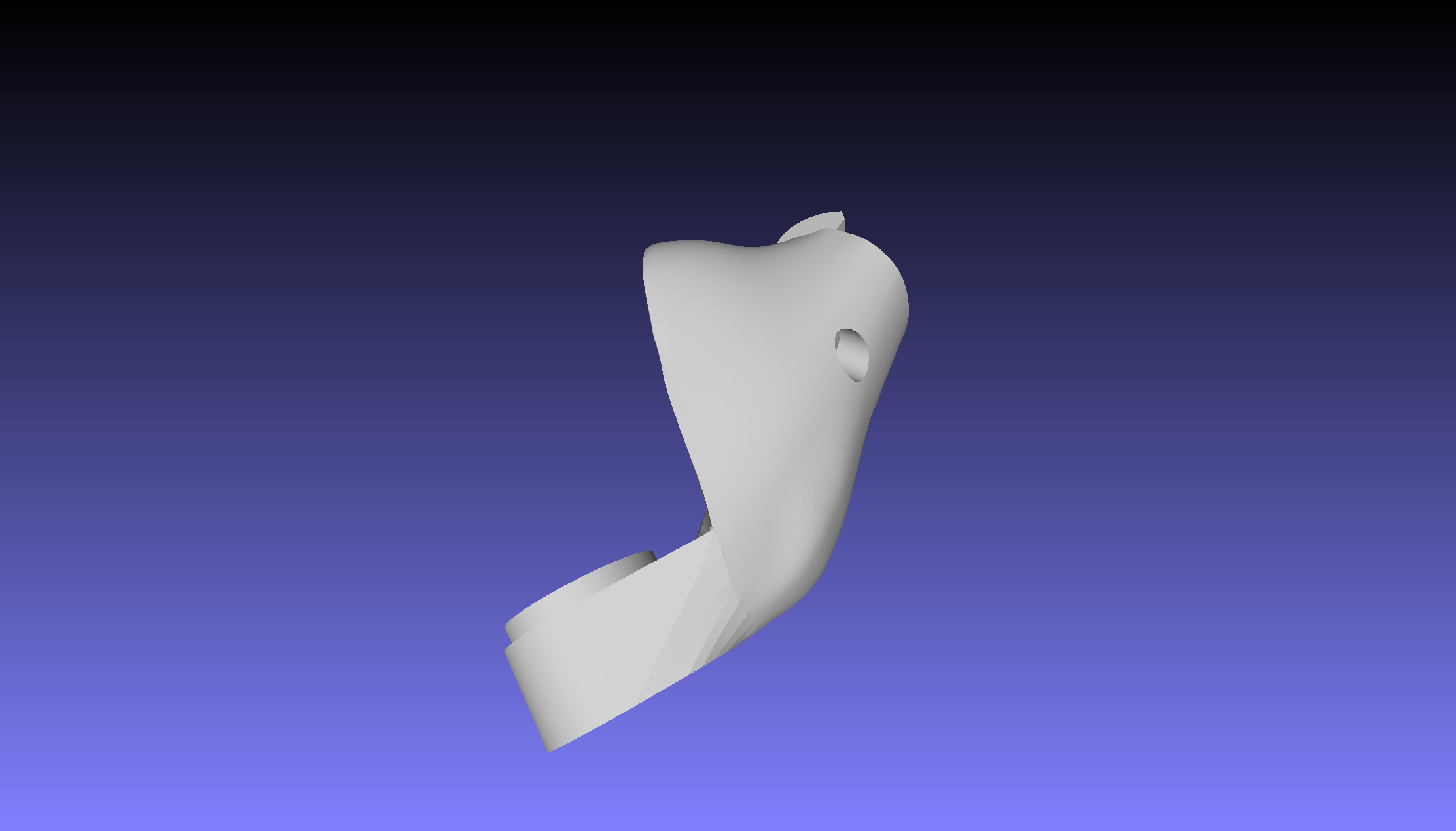

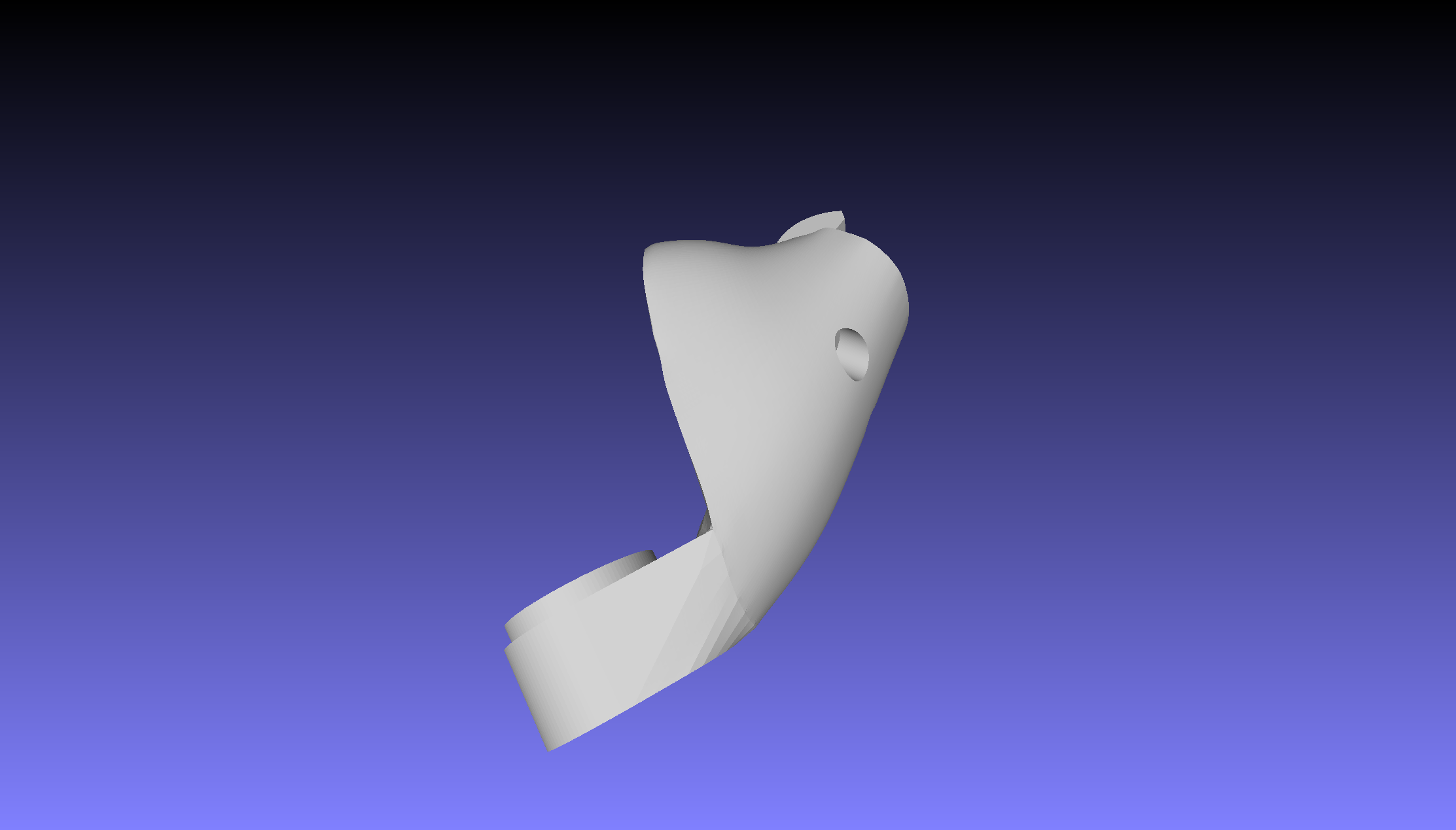

    After the thumb base broke during a power grasp with 100% force limit, the thumb shape has been reinforced
    Before:
    After:

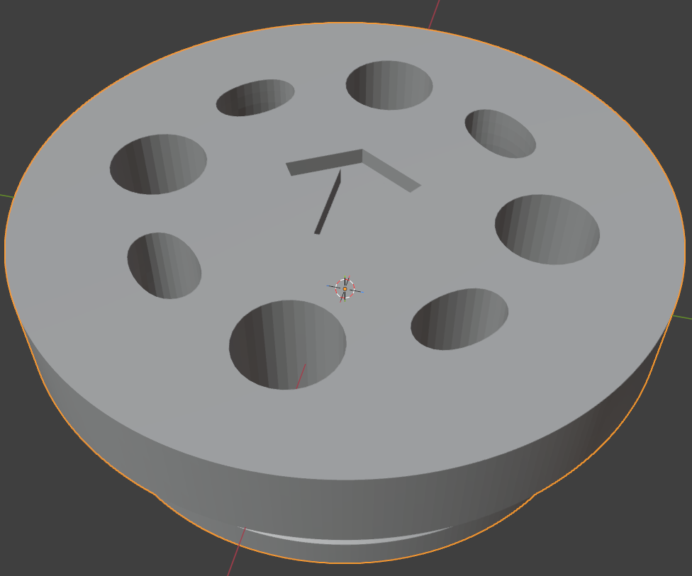

  • New component: Thumb Flexor Spool
    Vittorio Lumare03/06/2026 at 13:03 0 comments
    New Spool for the Thumb finger!
    Thumb finger has no extension spool, therefore we increased the thickness of the flexor spool by 2 mm, so it's possible to use the same bolts (10mm length) as the other spools.
    We also engraved an arrow on top for easy assembly.

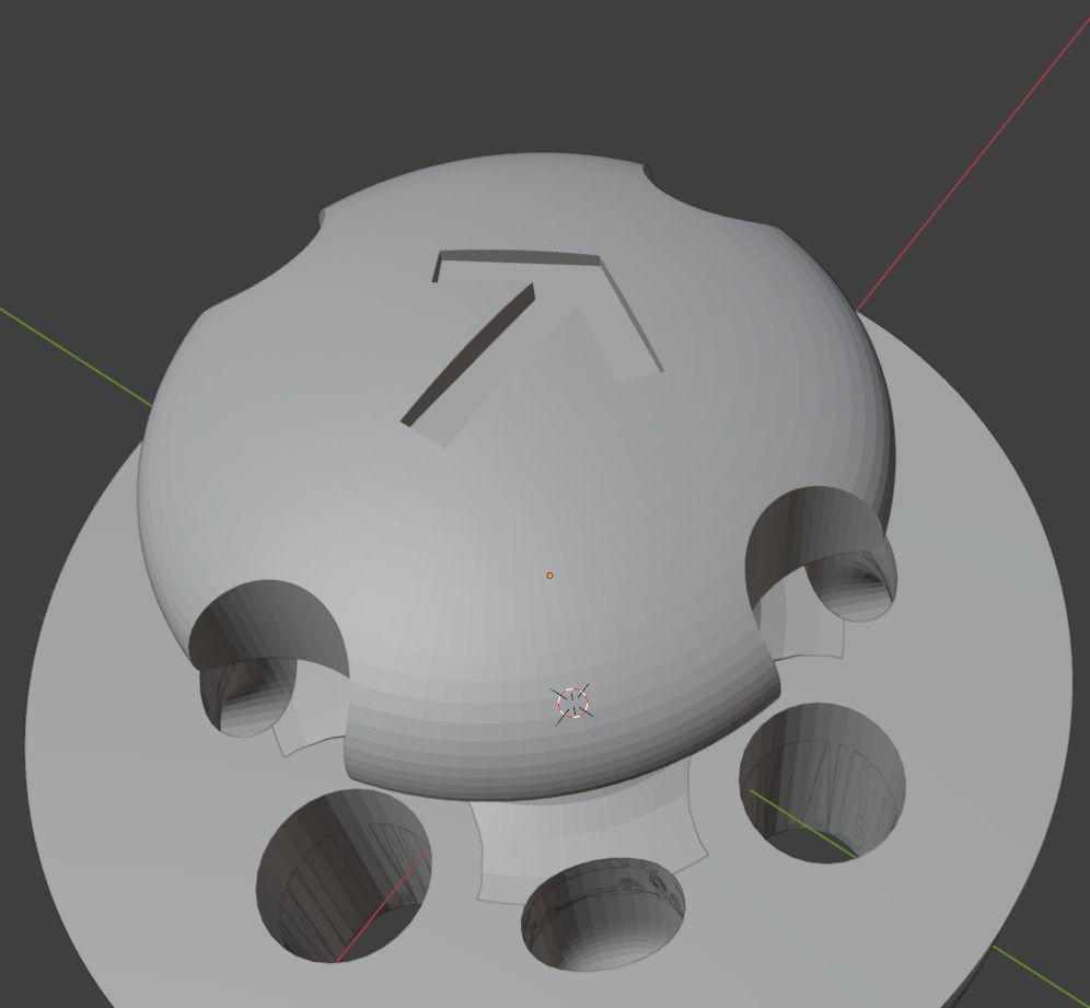

  • Extensor Spool - Engraved Arrow
    Vittorio Lumare03/05/2026 at 20:23 0 comments
    Added an engraved arrow to the extensor spool, so it's easier to assemble.

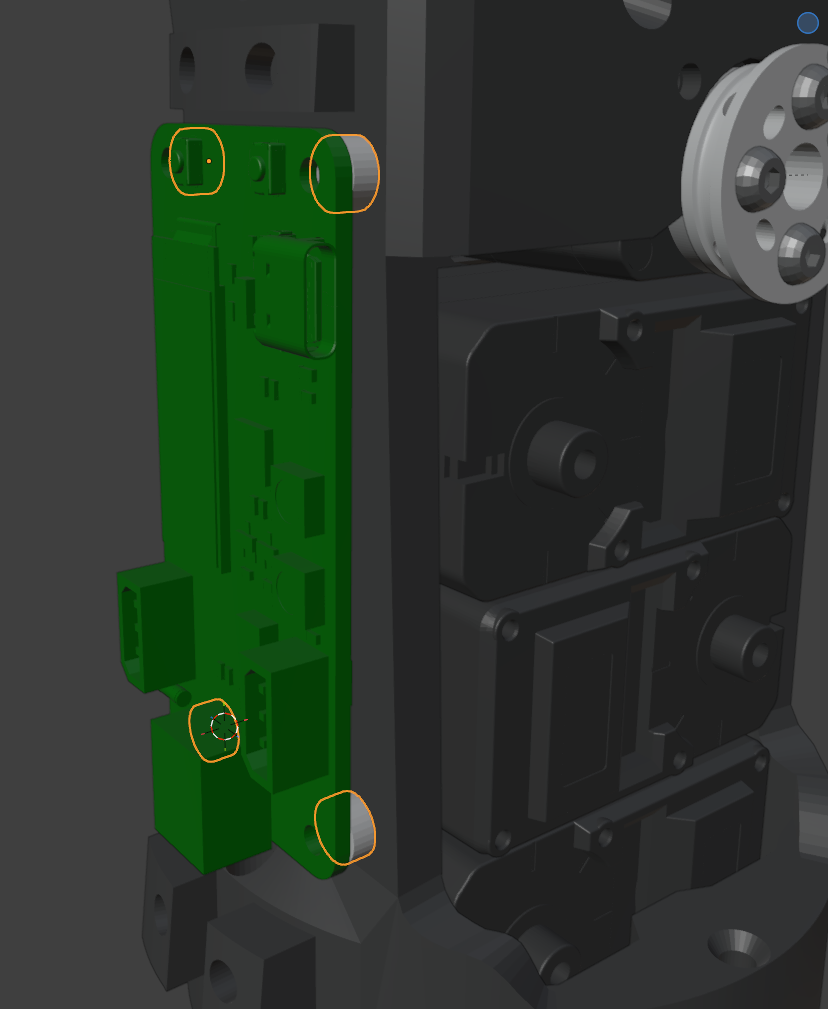

  • Updated support for PCB
    Vittorio Lumare02/25/2026 at 21:35 0 comments
    The Skeleton was updated: new supports for attaching the logic PCB board!
    We decided to move it on the skeleton side, instead of the front side

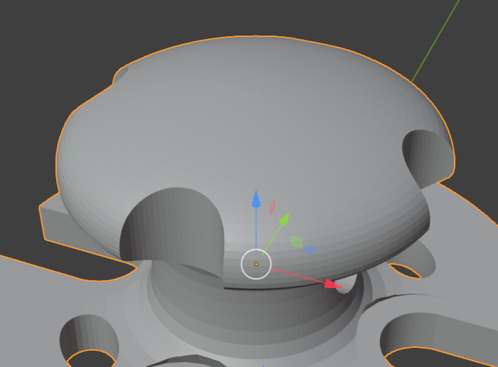

    • Safer Extensor spool (smoothed edges)
    • Stronger Flexion Spool (thicker border prevents deformation

    The extensor spools was too much sharp, I smoothed the edges in CAD so now assembly is less risky.
