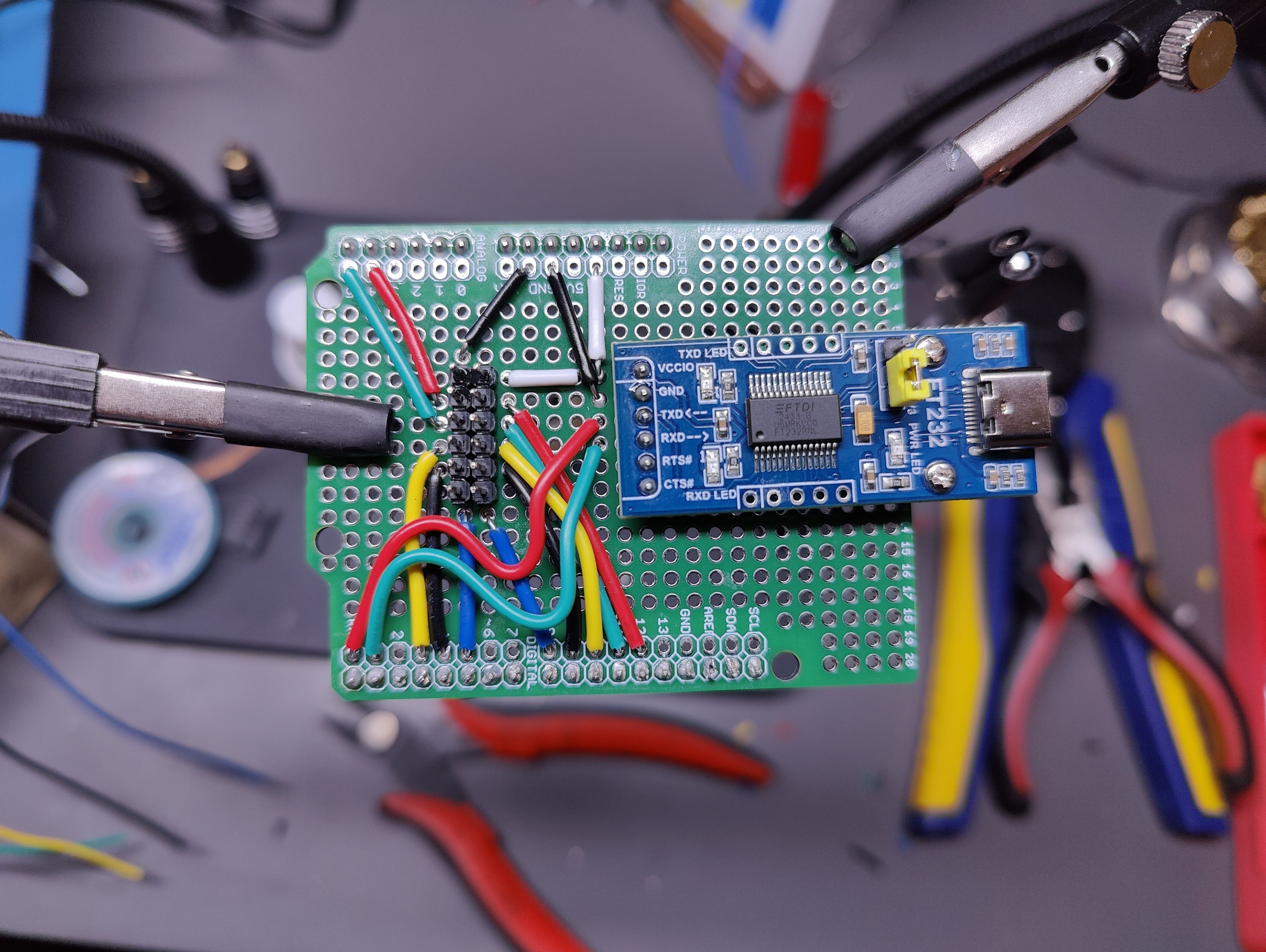

For the electronics I started with an Arduino Uno. After some breadboard prototyping of the individual components, I switched to a protoboard shield which I could add and remove from the Uno.  Fairly happy I went this route, as the Uno didn't end up working out, and this means I don't have to desolder it from a normal protoboard or something to get it back out to use for something else.
