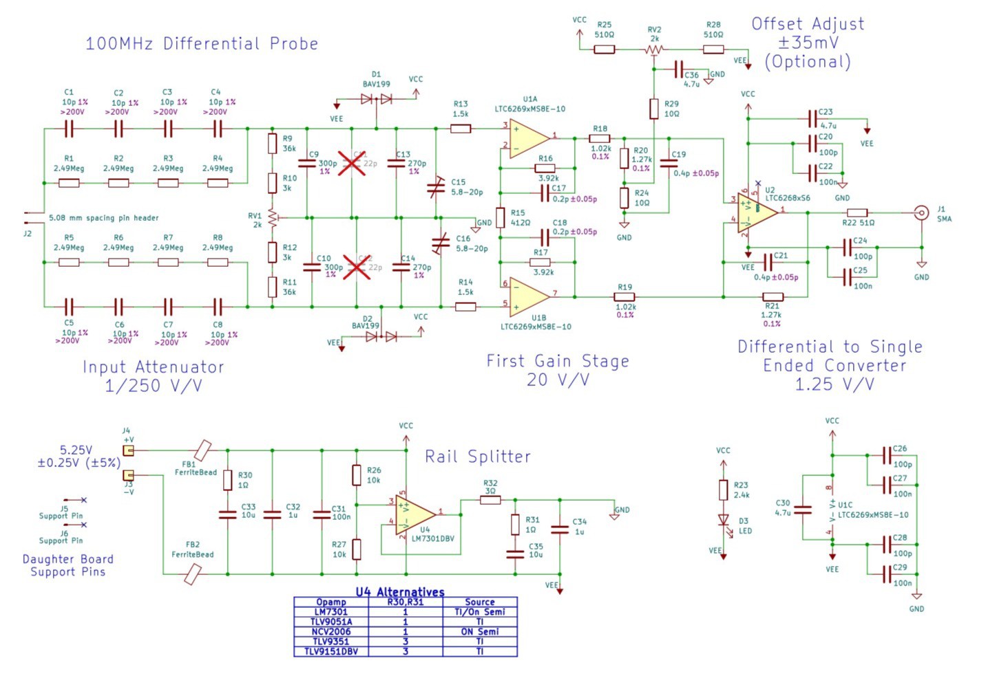

The 100MHz Probe Schematic:
No surprises here. This design was described in gory detail. See the old project.
Electrically, it is nearly identical to the previous design. C15-C16 were changed to a JR200 trimmer (or cheaper alternative), doubling the trim range. There are fewer bypass capacitors at the splitter output. FB3 was changed to R32, a 3 Ohm resistor instead of a ferrite bead, to prevent oscillation in U4. I changed the tantalum tank caps to ceramic and added a discrete snubber resistor -- it's too difficult to find a small tantalum with the correct ESR. A power indicator LED was added. C19 was added to improve CMRR at higher frequencies. Note that the schematic doesn't include any power supply options -- those are provided by the various daughter boards.
Users complained about the cost of the LM7301 opamp. There is a list of possible alternatives.

    The 100MHz Probe:
    When I decided to add the 10MHz and 1MHz versions I had to tweak the 100MHz probe a bit. All of the versions use the same PCB layout. The higher supply voltage on the slower versions forced me to change the larger tank bypass capacitors from 0402 size to 0603 because it is difficult to get large 0402 ceramic caps rated above 16V. Also, the input resistor string was changed from 3x3.3Meg + 62k to 4x2.49Meg using 0805 resistors (see reason below).
