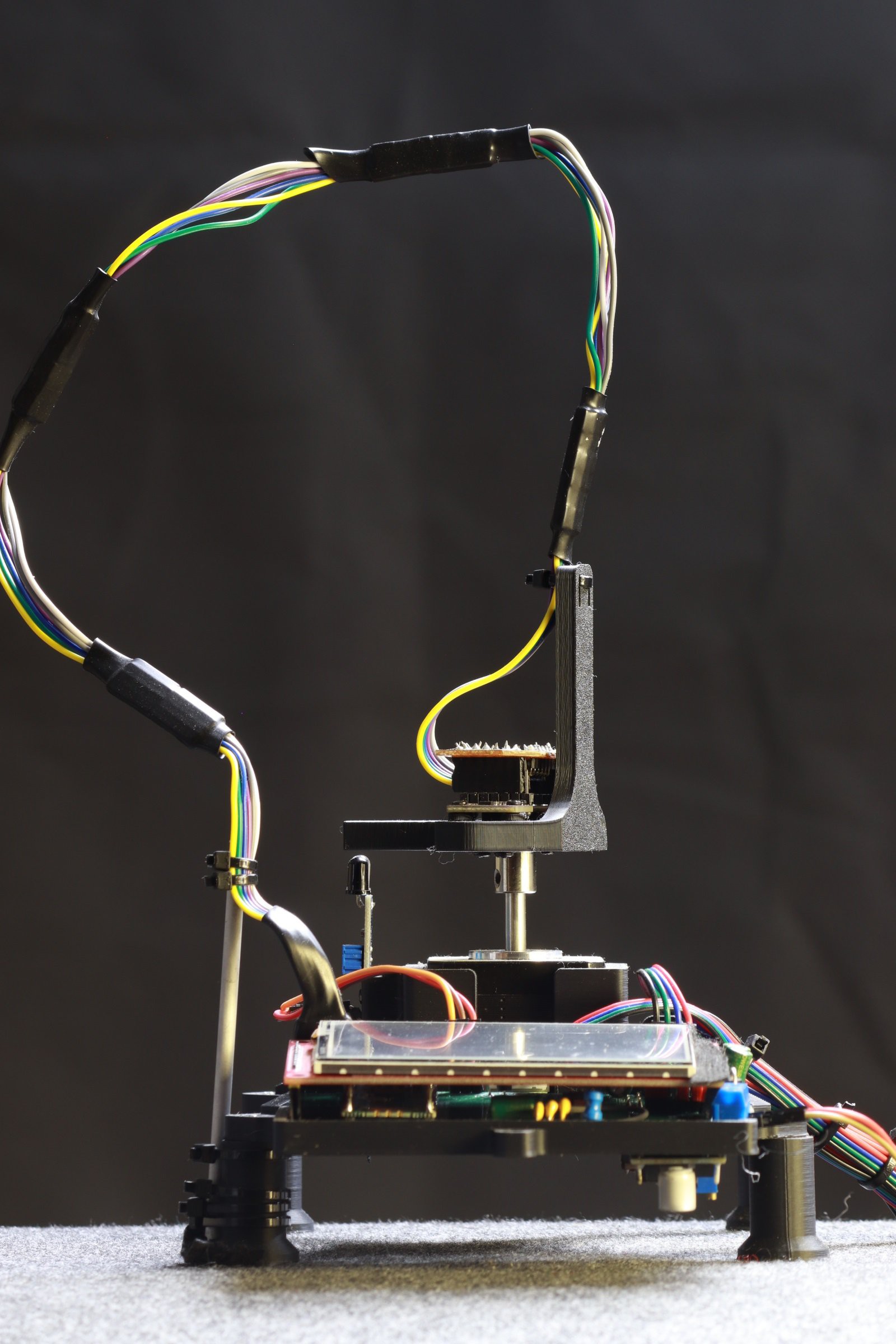

The prototype uses a Raspberry Pi Pico to run two BMI160 sensors mounted head-to-tail on a support driven by a NEMA-17 motor. By accumulating tens of thousands of measurements, It eliminates measurement bias through rapid reversal of the measurement direction. The use of dithering improves the resolution beyond the least significant bit (LSB). A five-state Kalman filter is applied at each position to estimate in real time the rotation rate along five directions in the horizontal plane. Finally, a cosine function is fitted to determine the latitude based on the amplitude, and the angle between the machine's reference frame and true north based on the phase shift.
🛠️ Hardware Architecture

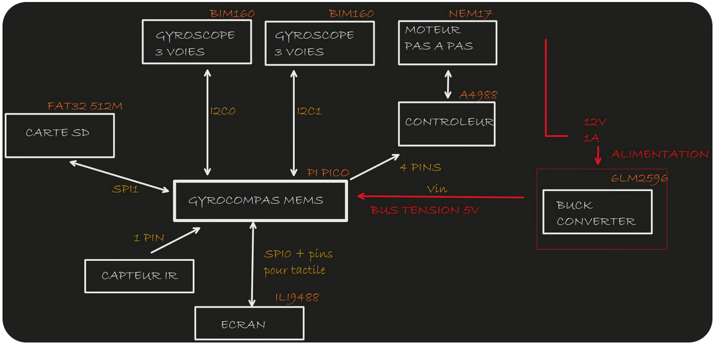

The prototype is composed by the following components:
  • Microcontroller: Raspberry Pi Pico
  • Gyroscopes: Two BMI160 MEMS gyroscopes mounted in a head-to-tail configuration
  • Motion System: NEMA 17 stepper motor controlled by an A4988 driver
  • Indexing: Infrared endstop sensor for zero-position referencing
  • Display: 3.5″ SPI TFT screen for real-time data visualization
This setup enables precise measurement of Earth's rotation to determine true north and latitude without relying on magnetic fields
