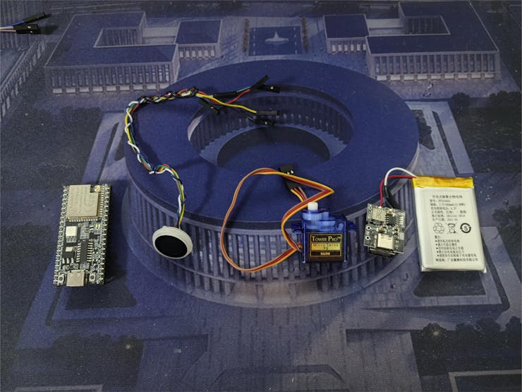

Core Components
Main Controller: Ai-M61-32SU development board (coordinates fingerprint
recognition and servo control).
Fingerprint Module: FPM383C for instant biometric scanning.
Lock Mechanism: 9g servo motor (compact, reliable torque for precise latch
control).

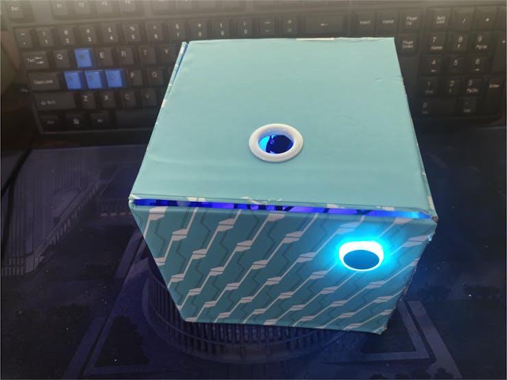

Prototyping Challenges

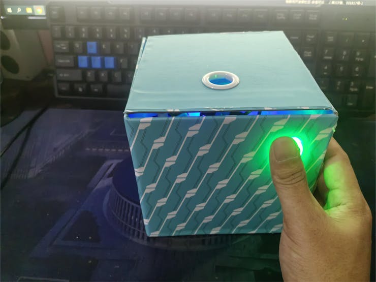

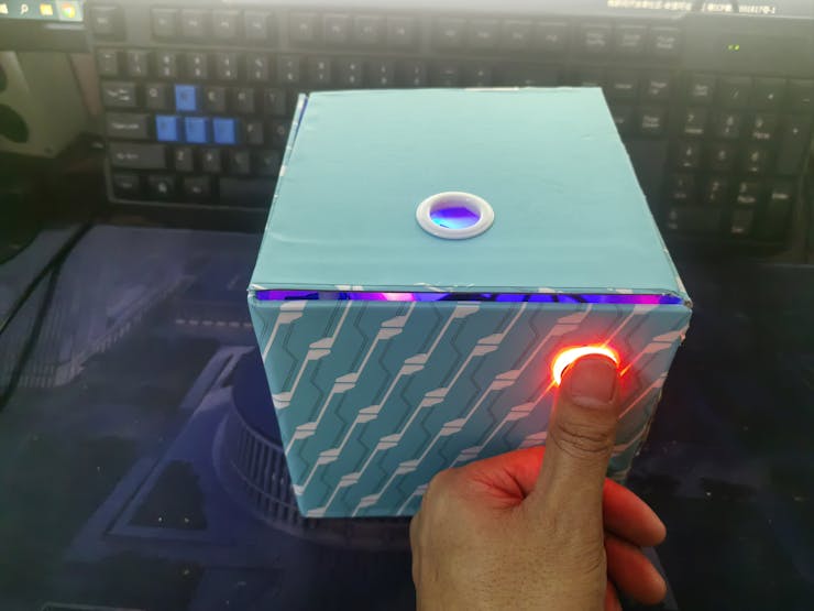

Planned a 3D-printed enclosure but improvised with a sturdy shoebox (flexible, eco-friendly, and surprisingly stylish!).
How It Works
Authentication: Place a registered finger on the FPM383C module.
✅ Green LED: Unlock successful → Servo opens the latch.
❌ Red LED: Unauthorized access → Servo locks immediately.

}Wiring Guide

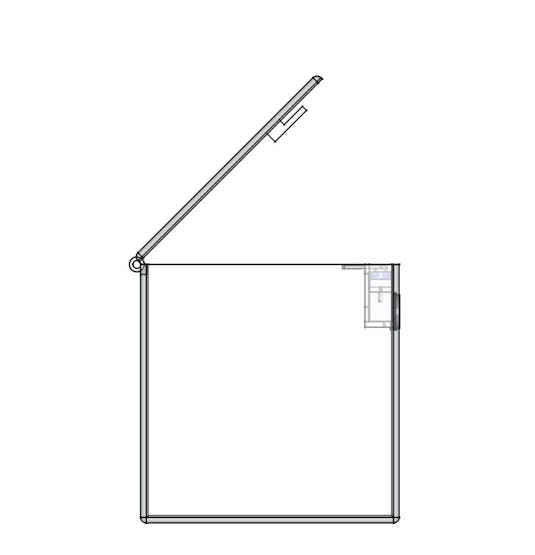

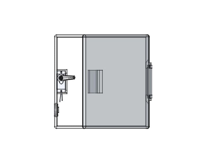

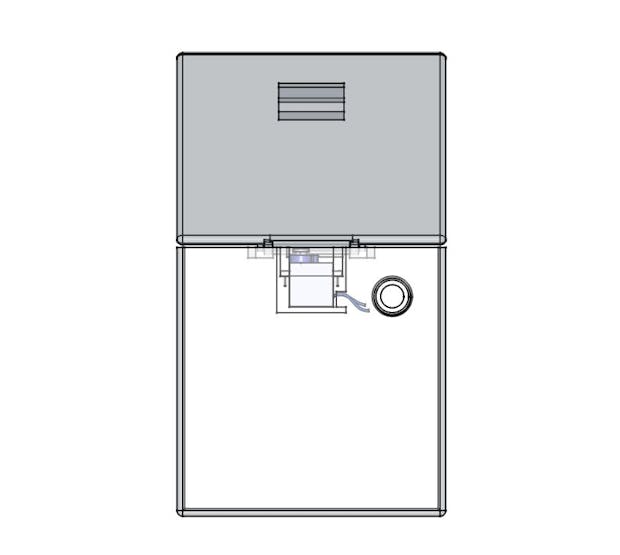

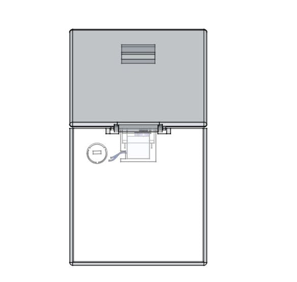

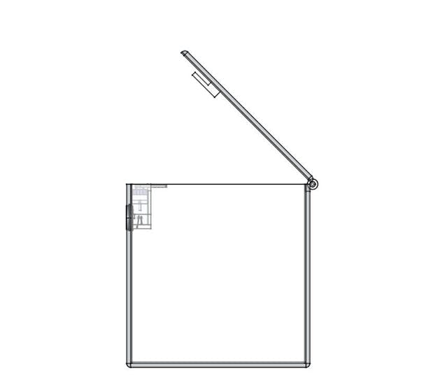

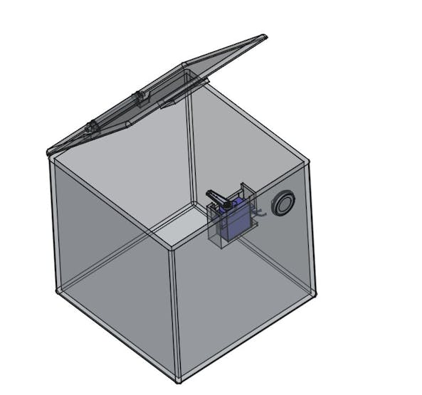

3D Model (FreeCAD Design)
