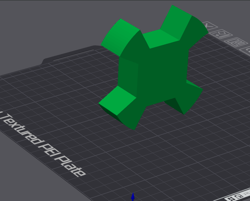

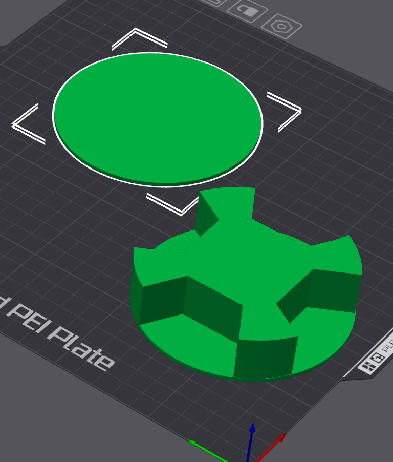

During theses sessions we print important pieces for our system such as the bulk wheel and rolls.
We created this wheel in 3D with compartments for the rice dispensor. The rice will flow into a pipe to the user's container. We will print it and also add a circle that will prevent the rice from falling from its compartment of the wheel. The rolls will be used for the conveyor belt. We also sewed the "carpet" with some fabric but at the end a carboard one was better and stronger.

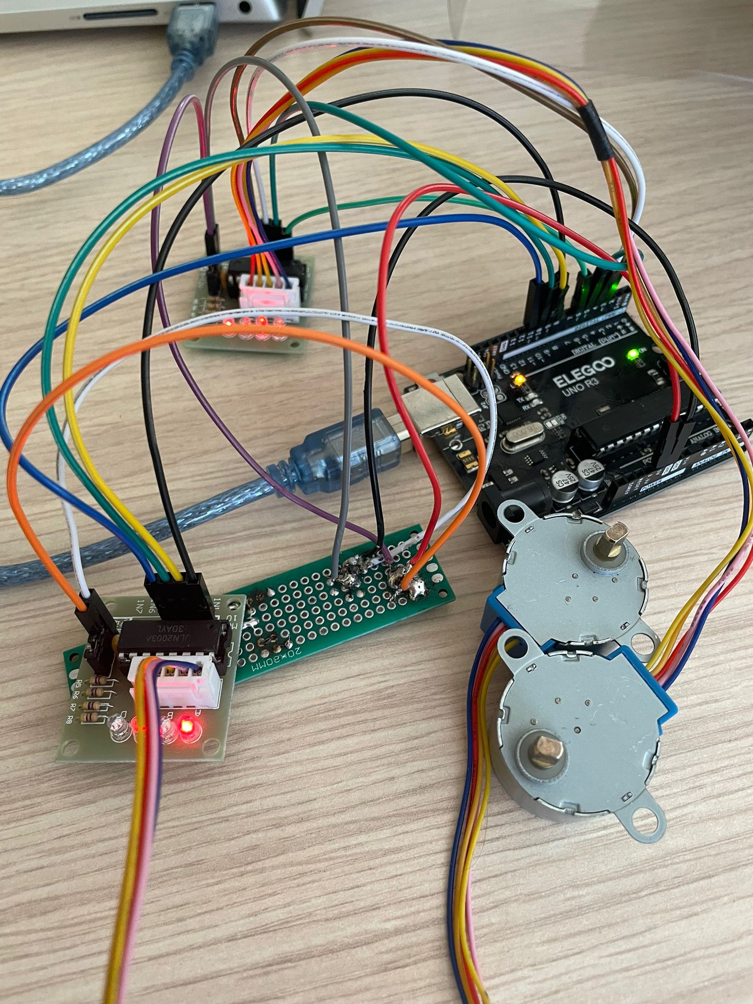

We worked on the input and in order to connect two step motors to the same input we weld them.

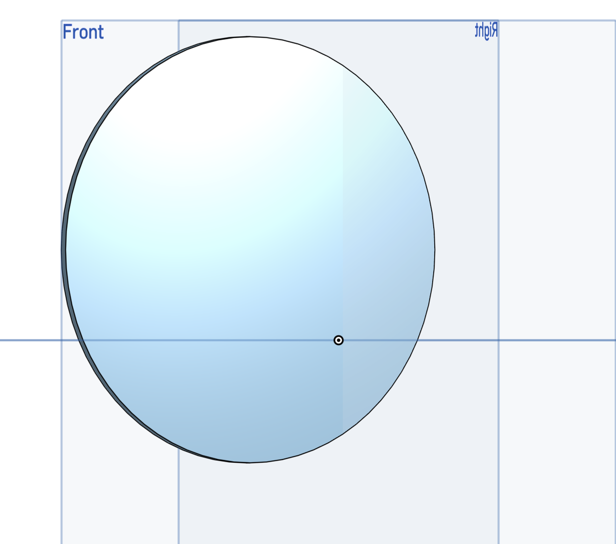

We designed these spiral rotating distributors for our vending machine prototype to efficiently rotate and dispense items, optimizing space and functionality.
3D IMPRESSION RESULT:
For the input we changed our mind because it didn't work and the deadline loomed closer. Actually we were able to make the sensor work but not to include them to the system. So we used :
- Potential sensor for the bulk system : the more you turn the faster the wheel turns and the product fall in the contenant.
- button switch for the spiral system : each spiral is connected to a button and when it's pressed the spiral will turn the product will fall.
- Touch sensor for the conveyor belt : When you touch the sensor the roll turns and make the system work so the product on the conveyor will fall.

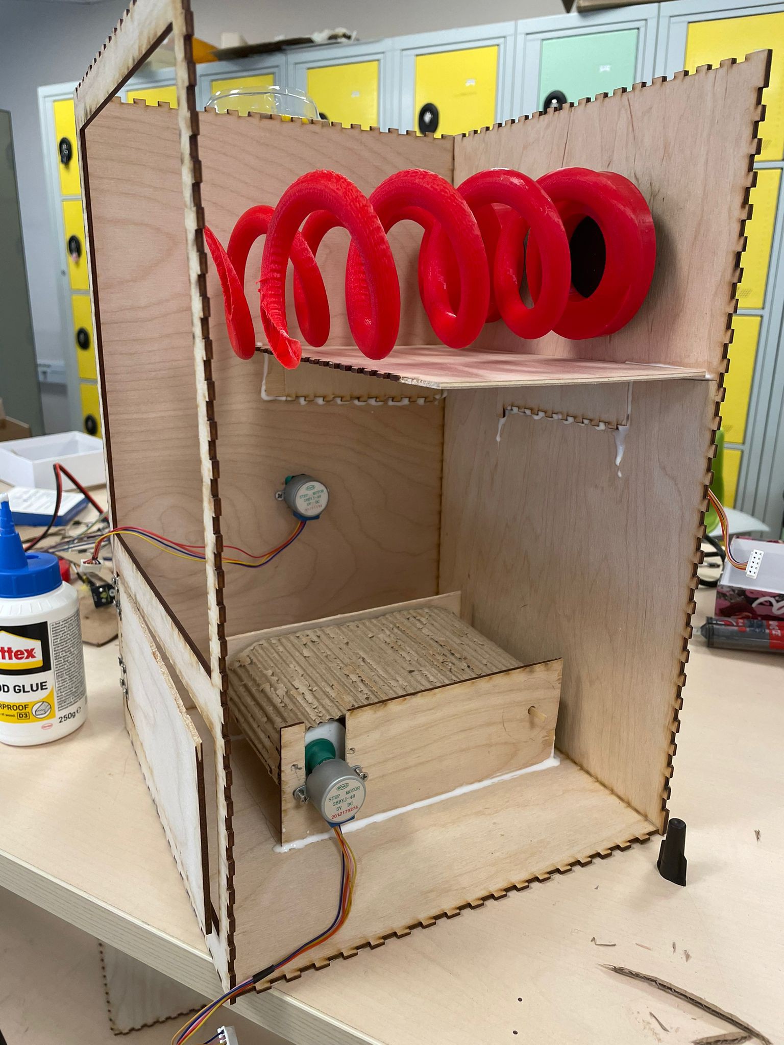

We 3D printed adapters that can be attached to the stepper motors to make our systems work. These parts ensure proper connection and functioning of the mechanism. Then we glued with epoxy the couplings and the different parts (spirals, wheel and roll)
We cut wood with the laser cutting machin to make our box.
ASSEMBLING OUR SYSTEM :
This image shows the assembly of our project, with the 3D printed spiral distributors placed inside the wooden structure.
The stepper motor is connected and positioned at the bottom, ready to operate...
