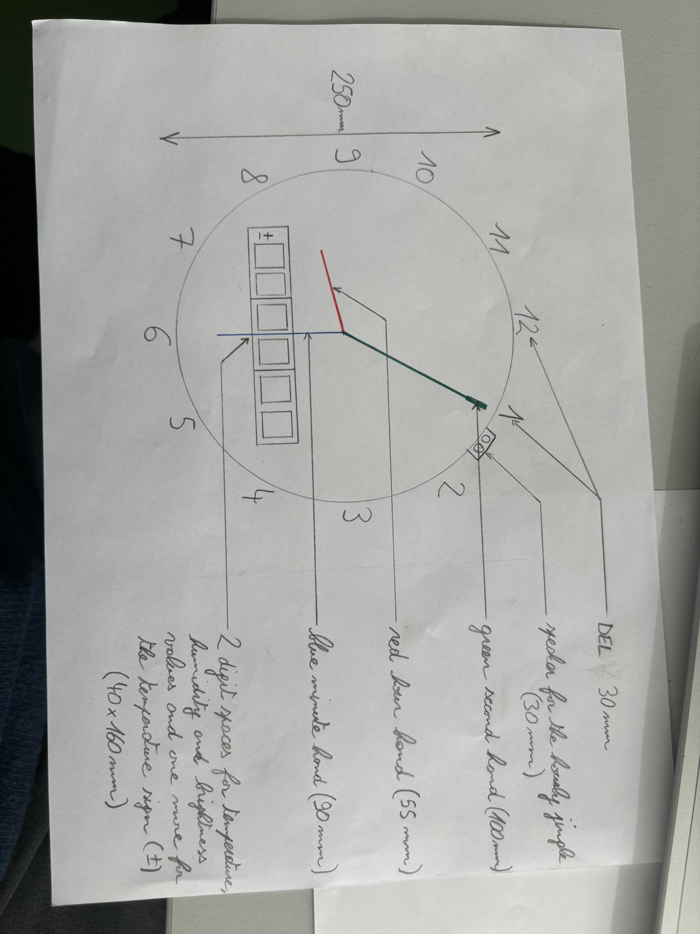

    Today, we took a step back to imagine the project by making sketches and thinking about its functionalities. Then, we started building the cardboard prototype.
    When we began working on the cardboard prototype, we encountered a major problem. We couldn't place all the hands on the same vertical axis because they would inevitably touch at some point. Additionally, it was impossible to position all the hands on the same rotation axis, as we couldn’t just stack the servomotors on top of each other or attach multiple hands to the same servomotor (otherwise, they would all rotate simultaneously, which wouldn't be useful).
    However, we came up with an idea! Instead of using three hands, we decided to keep only one—the minute hand. As for the hour indication, we thought of making the RGB LEDs on the numbers change color (to red) when an hour transitions to the next.
    We’ve also start to make the arduino code this week but we ended by only making the connection of the arduino card.

    Today, we continued what we started last week, which was visualizing our project idea. We created sketches (including dimensions and project details) and a Fusion 360 representation to model the project in 3D.
    We also created the Hackday project page (where I am writing this log), where I documented all the logs and uploaded the images.
    Additionally, we considered making a cardboard prototype of the project, but we didn't have enough time to complete it. We will do it next time to kick-start the technical aspect of the project.
    (I have uploaded the sketch and the Fusion 360 file in the files and images section.)
