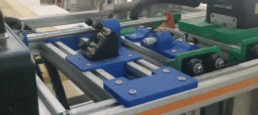

General Description

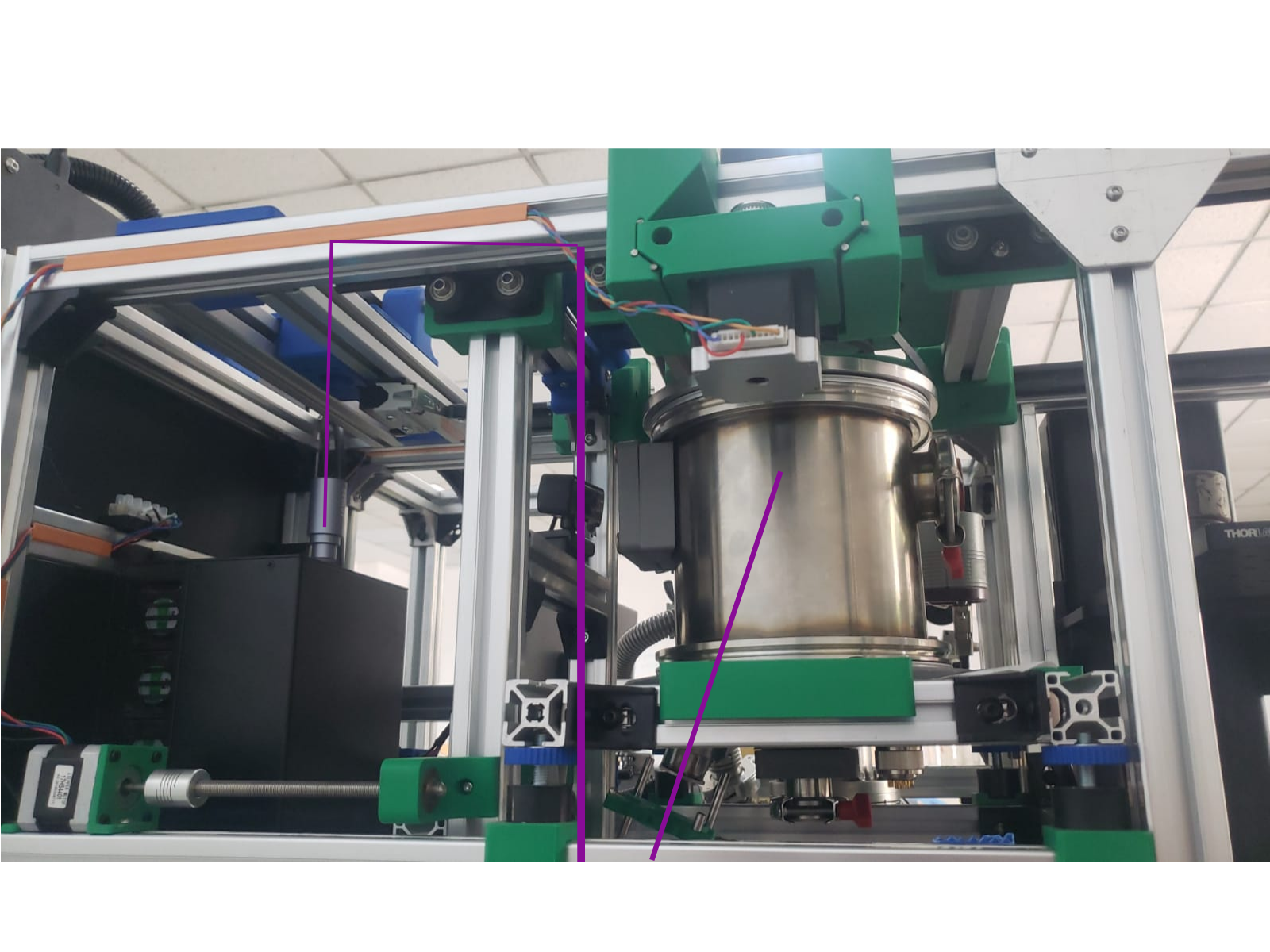

To make room for the intended alterations and new optical path, a whole new frame was fabricated:
It holds the laser source, vacuum system, optics and everything needed for a working machine, except the rotary vacuum pump (to decouple vibrations) and control computer.
The laser is held vertically, where the light from the source goes up towards an adjusting/steering mirror which reflects it in a 90º angle. Then, there are two alternative optical paths, depending on the position of a mirror which is located at the top of a moving carriage:
For deposition, the mirror is positioned in such a way that light reflect downward again,

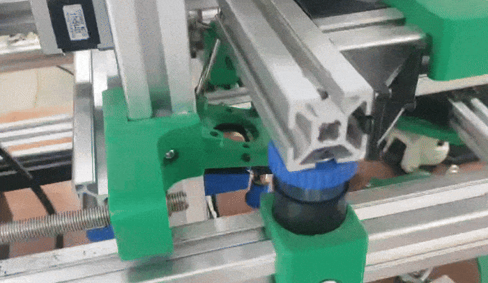

towards a scanning stage which rotates on it's own axis in order to be able to steer the beam over the targets, providing uniform removal of material.
This stage also holds a lens which focus the light onto a tight spot. It's worth noticing that in order to efficiently couple the radiation onto the target, it's very important to use appropriate optical elements which minimized absorption and unintended reflections. All the mirrors used are based on dielectric stacks, with reflectivity over 0.99 at 355nm. However, the lens is made of glass (a bit of absortion loses) and with a broadband AR coating, which might not be ideal either. The vacuum window is made of uncoated fused silica, which reflects quite a bit of light (even though incidence angles are rather close to normal). Better transmissive optics are on the way.
This movement of the whole carriage was made so in order to keep at least one of the degrees of freedom of the scan parallel to the surface of the target, avoiding in principle at least variations on light spot size while scanning.
![Scannind Scannind]()

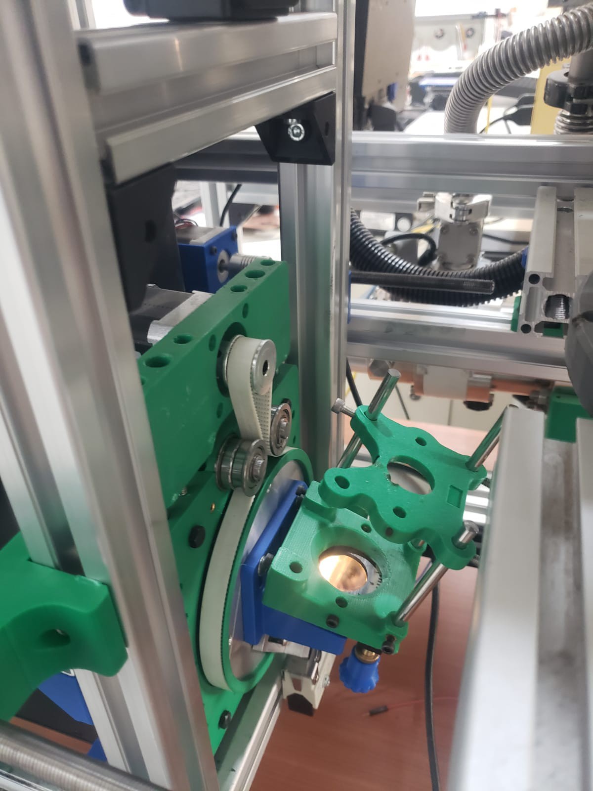

The required angular variations to scan over the 25mm targets are in the order of +- 1º But then we also need to machine the tape to make our shadow masks.
When the moving carriage within the frame goes to it's 'home position' (to the left), a pushrod moves the second mirror downwards, in such a way that the horizontal beam goes straight towards the galvo scanner entrance:
As the beam path towards the scanner is sometimes obstructed but never moved, it should hold the repeatibility of the scanner, which is one of the more critical parameters for the machine, as it influences directly interlayer registration between structures.
As might be seen from the image, the scanner is also on a moving stage. This is needed to provide access to the chamber, and it also allows to use the ablation capacity of the laser to perform other operations, such as PCB etching.![]()

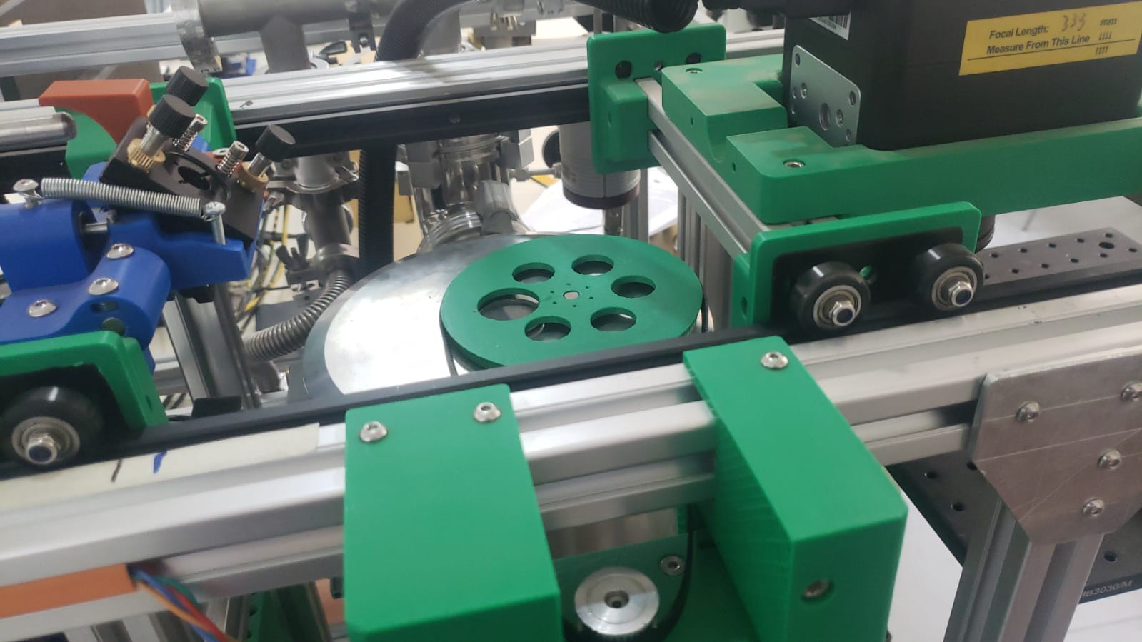

So basically the workflow is quite similar to the previous iteration: A blank mask is placed on front of the substrate, then the carriage moves home to select the first optical path, where light is fed to the scanner in order to machine the apertures on the mask according to a given layer design.
Once micromachining is finished, the carriage moves forward to change the optical path, and the laser is scanned over a given (sequences of) target to generate a set of features of that material through the mask. As already stated, this basic process can be repeated several times with different deposition procedures and an arbitrary number of masks to generate complex thin film based heterostructures.

Now such mechanism seems to have a fair bit of degrees of freedom: Target carousel, shutter, and mask roll movement is required. However, they move in a fairly well defined sequence, so in principle all movements could be partially coupled to one another in order to reduce the required actuation elements.
