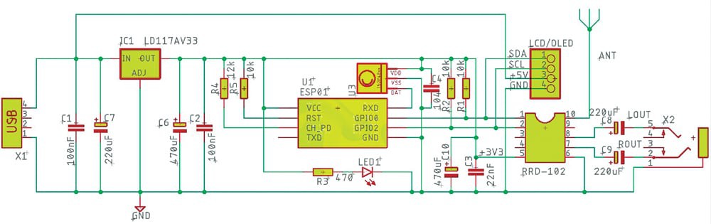

In ESP-01 out of four possible GPIOs only three GPIOs are used.  GPIO1 still available for future use.
FM tuner, OLED or LCD and EEPROM IC(24C0X) shares the same I2C bus.  EEPROM  used to remember the last used channel frequency and volume settings.  The GPIO3 input is used for IR remote receiver input(RX) pin.

ESP-01 pin map
       GPI00 - SDA(FM tuner + OLED or LCD + EEPROM)
       GPIO2 - SCL(FM tuner + OLED or LCD + EEPROM)
       GPIO3 - Rx - IR receiver

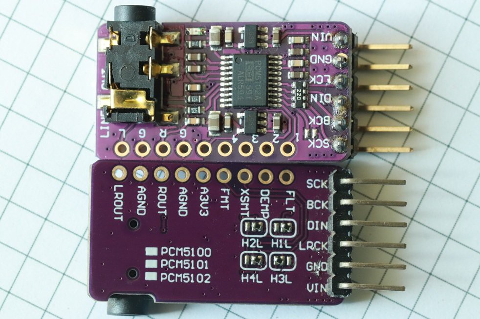

    We can directly plug the I2S DAC module using PCM5102. The SCK signal connected to GND in the base board. No need to connect the SCK to GND in the PCM5102 module. This DAC capable of driving 32 Ohms head phone directly.

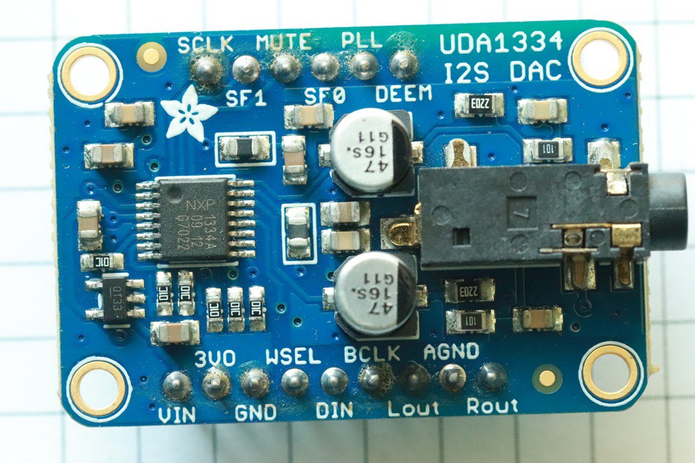

    The UDA1334A I2S DAC tested with FM Radio. We can not plug directly into the base board. We need to connect the base board and I2S DAC through short jumper wires. This DAC capable of driving 32 Ohms head phone directly.
