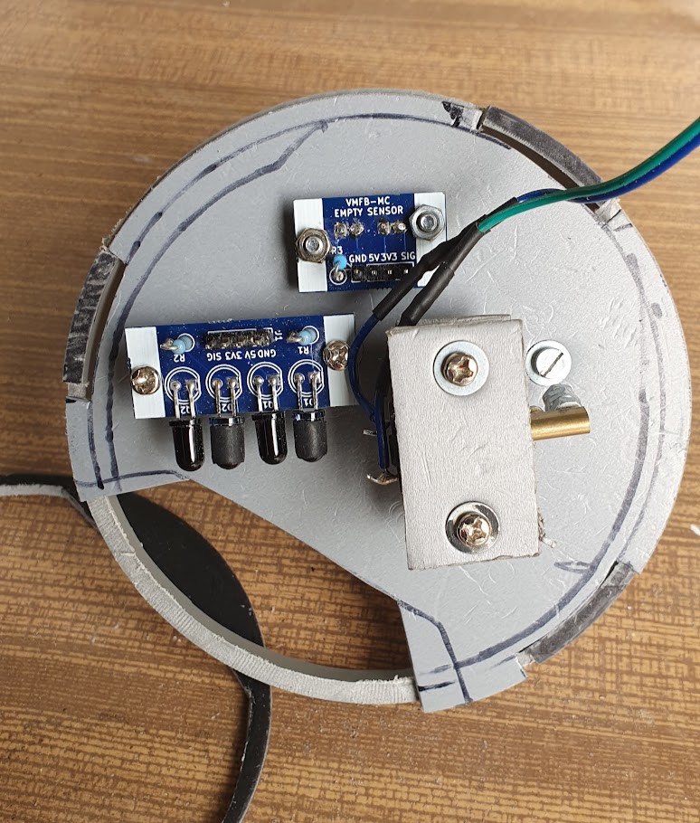

ELECTRONICS, SENSORS, AND POWER
The circuit is all analog, using four NE555 timers and one LM358 dual op amp. The sensors are all made using IR phototransistors and IR LEDs. The PCB has headers broken out so you can monitor and control it with a microcontroller or SBC. It runs on 5-6VDC, but be sure to use 5V if you are planning to power a USB device (like a camera) with the vending machine's USB ports. If you use a USB cable to power the vending machine, be sure it can deliver enough current. I found that some 10-year-old 2-meter USB 2.0 cables were resulting in a voltage drop from 5 to 4.5-4.8 volts on the vending machine power rail.  Cables that didn't work so well had a resistance >1Ω. Ones that did had a resistance of <0.5Ω. NE555's should get at least 4.5 and Raspberry Pis need at least 4.7V. If things are not working as expected, use a multimeter to check the rail voltage - it should be around 4.9V. Shorter cables are less lossy and take up less space inside the enclosure.
Power consumption at 5V is as follows:
Without RPi Zero W
  • Idle with Powerbank Keep-Alive and TImer enabled: 18mA
  • Timer uses 8mA
  • Powerbank Keep-Alive uses 4mA
  • ^With both of these disabed it uses 6 mA
  • IR LEDs on: 320mA
  • IR LEDs and motor on: 510mA
With RPi Zero W and wide-angle camera module
  • Idle with Powerbank Keep-Alive and TImer enabled: 220mA
  • IR LEDs on: 520mA
  • IR LEDs and motor on: 820mA
So with the Rpi and camera you could get about 2 days out of a 20,000 mAh power bank. With just the vending machine you could get about 10 days.
Modules
  • Powerbank Keep-Alive: 555 sinks current every 7-22 seconds for 0.7-2.2 seconds to keep USB power banks on while sensors are in standby - the powerbank keep-alive can be disabled.
  • IR LED ON/OFF: 555 keeps the IR LEDs used by the sensors on for 22 seconds after the last PIR trigger
  • Op Amps: LM358 used as comparators to adjust the threshold of the sensors and send signals when they are triggered
  • Motor Controller: 555 turns on the dispenser vibration motor when the deposit sensors are triggered, tuns it off when the dispense sensor is triggered
  • Timed Dispense: 555 dispenses food every 10-100min - timed dispense can be disabled
  • Daytimer: Phototransistor that puts the timer in reset while it's dark outside - brightness threshold can be adjusted or disabled (Rev. B)
  • PIR Sensor: Sends a signal to turn on the sensor IR LEDs
  • Deposit/Dispense Sensors: IR phototransistors and IR LEDs used as proximity sensors to monitor the deposit and dispense chutes
  • Hopper Level Sensor: IR phototransistor and IR LED to detect when the food level gets low (Rev. B)
  • Monitoring/Control: lines for monitoring and triggering events with an external controller (Rev. B)

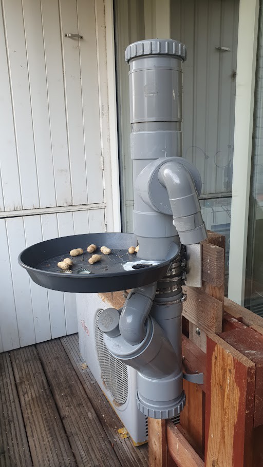

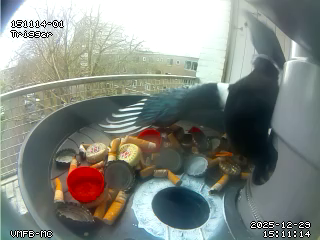

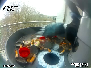

  • Magpies on the edge
    Stephen Chasey12/30/2025 at 01:07 0 comments
    I moved the dispense opening close to the deposit opening and modified it so peanuts would not spill out onto the platform. The goal was to force the magpies to walk on the platform instead of just using the rim. This way they would be more likely to sink some accidental depostis.
    Unfortunately they are pretty adamant to not walk on the platform if it can be avoided. They would rather touch it with their wings than their feet. Something to work on...

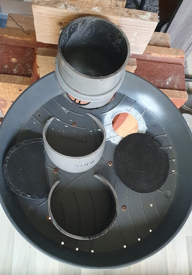

  • More Changes More Problems
    Stephen Chasey12/20/2025 at 22:54 0 comments
    I redesigned the entire interior of the feeder to make it smaller, easier to build, cheaper and somewhat ironically more reliable. I've already had a few problems that I hope I've fixed.
    The place I get peanuts changed suppliers or something and the peanuts are a bit bigger now. I had to cut away a bit of the baffle over the dispense opening once I found an entire hopper of peanuts jammed above it thanks to a few finger-sized peanuts that got stuck.
    I want to change the design yet again to put the deposit hole in front of where the nuts get dispensed. I think this will increase the likelyhood of accidental deposits and the chance that the birds see the result (getting a nut) so they can reason it out.
    I initially moved the deposit chute away from the dispense opening so dispensed nuts would not find their way into the deposit chute. This happened once when I was still on shelled peanuts and pigeons. The dispense cup had a few peanuts in it and the ones coming out were bouncing off them into the deposit chute causing more peanuts to come out.
    The next design will not dispense nuts onto the platform - the nuts will stay witiin the enclosure and it will have a larger dispense opening (50x100mm) facing forward so birds can see and reach in easily. The deposit opening will be in front of thiis opening at its center.
    This change is more about getting results from the birds than any mechanical or material efficiency. I've noticed that while jackdaws walk around on the platform and accidentally deposit sometimes, magpies typically stick ot the rim of the platform and seem to avoid walking on it. Hopefully this change will lure them closer and increase the chance they associate deposit with dispense.
    UPDATE
    Since I can rotate the dispense opening on my current design I can take a bit of a shortcut and just lower the dispense baffles so the nuts stay within the dispenser.
    Then I can rotate the opening closer to the deposit hole. The birds will take a good look inside to make sure they didn't miss anything. Moving dispense and deposit closer together will require the magpies to walk on the platform to get to the nuts, and have a higher chance of accidentally depositing and figuring out the cause and effect.

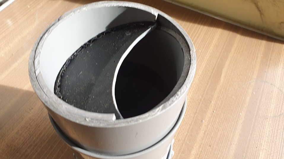

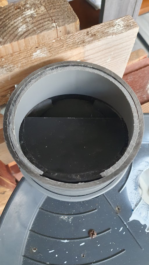

  • Baffle angle and clearance
    Stephen Chasey11/27/2025 at 14:51 0 comments
    I've been having more dispenser jams with the new design and the reason turn out to be the increased baffle angle. I made it steeper thinking it would make sure the peanuts would roll off of it onto the vibration platform. The side effect is more lateral force on the peanuts. Peanuts in the shell are relatively light (compared to shelled nuts) and have a rough, irregular exterior - even a little lateral force is enough to jam them up.
    So I'll be going from ~30° incline back to a ~15° incline to fix this. Otherwise, everything is working well.
    UPDATE
    The angle of the baffle is somewhere between 20° and 30°, about the minimum for unshelled peanuts to reliably roll off of it so none get left behind. On the old baffle, there would be a few peanuts sitting on it once the hopper was "empty". Instead of reducing the angle I cut a couple square cm from it and raised it about one cm to leave more clearance for the nuts to pass by.
    This seems to have fixed it - no more jams within the dispenser and quick, reliable dispensing of 1-2 nuts per dispense.
    UPDATE 2
    The angle of the feeder also matters. Since I simplified the mounting system, it is possible for the feeder to be mounted not quite vertical. In this case it was leaning a few degrees away from vertical making it more difficult for peanuts to reach the dispense opening. Adjusting this reduced the dispense time and increased reliability (no jams).

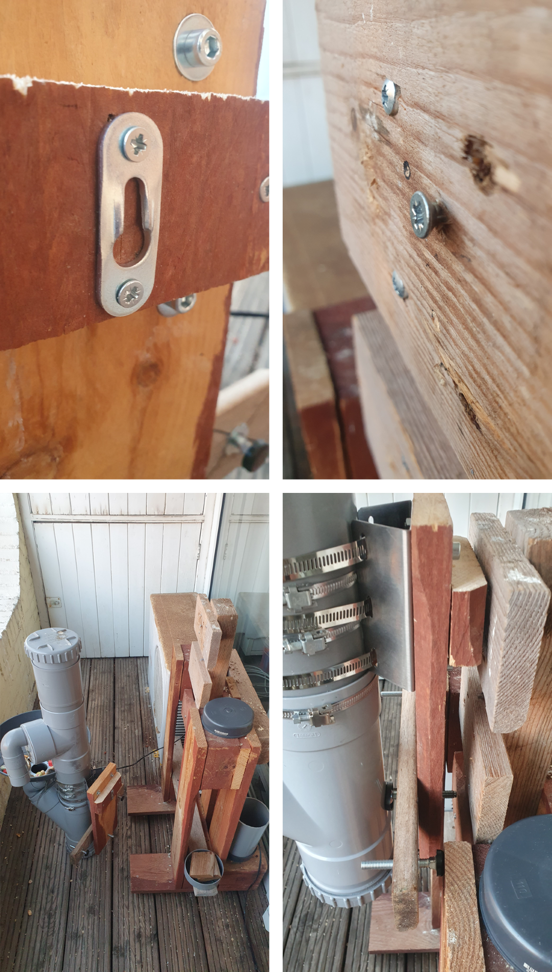

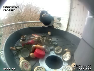

  • Redeployed
    Stephen Chasey11/10/2025 at 21:17 0 comments
    After a couple more tweaks, I turned it on and left it in timed dispense mode. The magpies and jackdaws remember it as a food source (even with a slightly different enclosure) and are visiting it already.
    I extended the dispense pathway tube to allow for a better fit for the mounting bracket and cleaned up the hose clamp mess by removing two of them. - now three hose clamps secure the mounting bracket and two of those also secure the platform. The fourth one below them secures the deposit assembly.
    The mounting setup is improved a bit as well. You can mount it on a wall or fence with just one screw. Three adjustable feet provide additional support and levelling.
    There are of course a couple more tweaks to the enclosure I want to make, but this is pretty close to final form as far as 110mm PVC goes. So it's open for business. I hope to make some progress with these birds in the coming weeks.

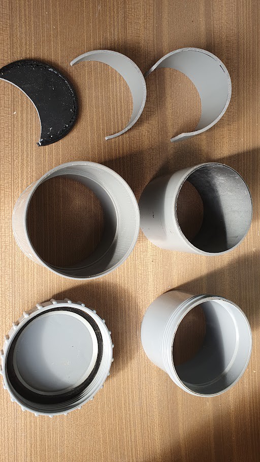

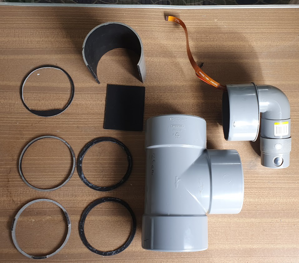

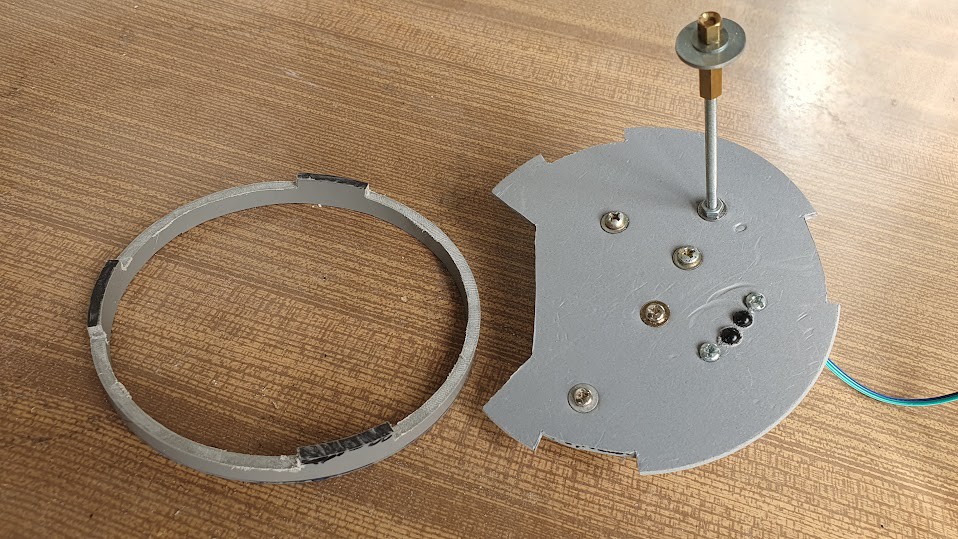

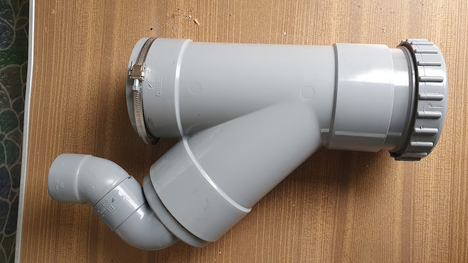

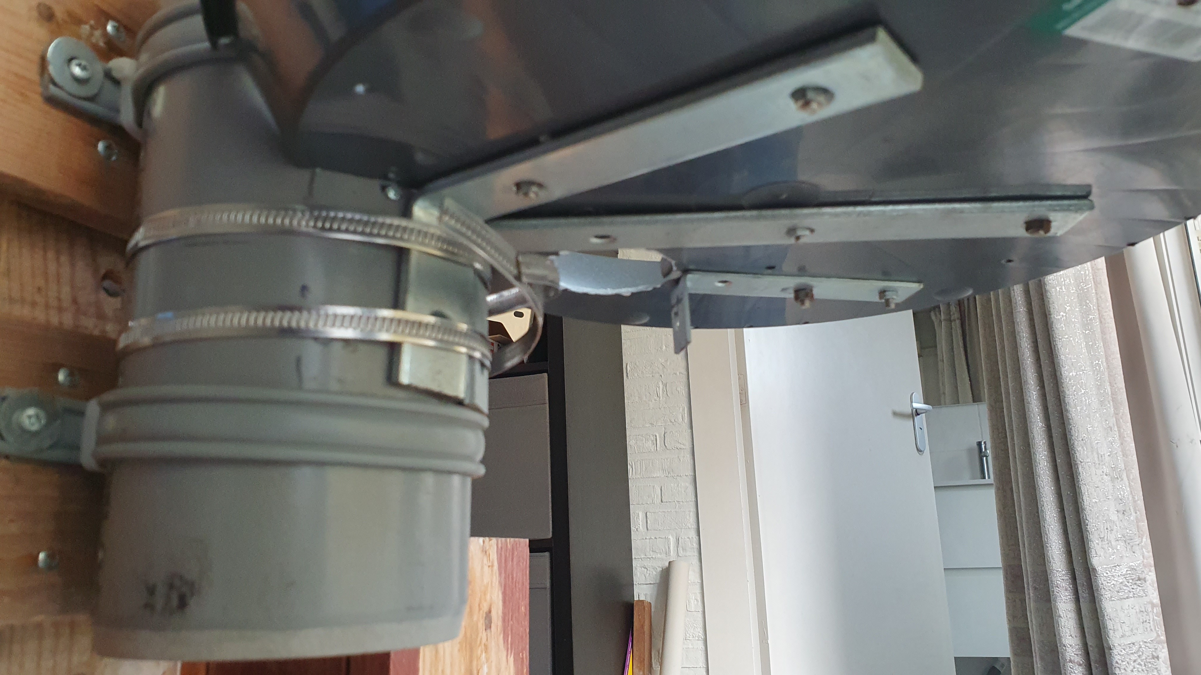

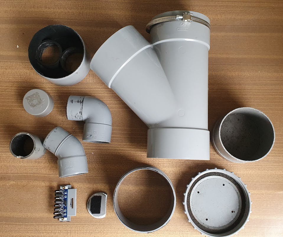

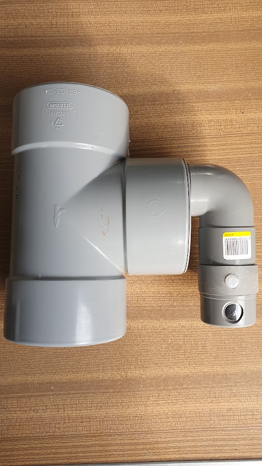

  • New Enclosure and Mechanicals
    Stephen Chasey10/21/2025 at 20:29 0 comments
    So I made the following improvements to the enclosure and internals.
    • The feeder is now 86cm (34in) tall (down from over a meter on the previous version)
    • Fewer parts and materials (and shorter wires) required to build
    • PIR sensor moved to camera arm
    • Dispense path is more difficult to jam
    • Deposit pathway is shorter and easier to mount the sensor on
    • Better way of placing internal baffles
    I've tested it, but have left it turned off for now. I'll first turn it on and let it run on a day I can work from home to monitor it. It took a bit of tweaking to get everything to fit while keeping it simple.
    Here's what it looks like now vs what it looked like before.
    Now
    Before
    I tried using one of those pole mounts for lights and cameras, but in reverse. I got this for 11 EUR on Amazon.
    It works prety well, but the feeder still needs a secondary point of support below the mount. I used a leftover bit of 110mm PVC pipe for this, but will hopefully think of a better way soon. If you are looking for hose clamps, sorry, I'm using all of them right now.
    The enclosure is now basically 4 sections. Here they are, and the parts they're made of.
    1. The deposit assembly.
    2. The dispense platform
    3. The electronics
    I was too lazy to disassemble the camera arm - it consists of:
    • 110mm to 50mm adapter
    • 50mm 90° elbow joint
    • ~10cm length of 50mm PVC pipe
    • ~3cm 200° arc of 50mm PVC pipe to secure the PIR lens
    • 50mm PVC end cap
    • small piece of transparency to protect the camera lens
    4. The hopper and dispenser
