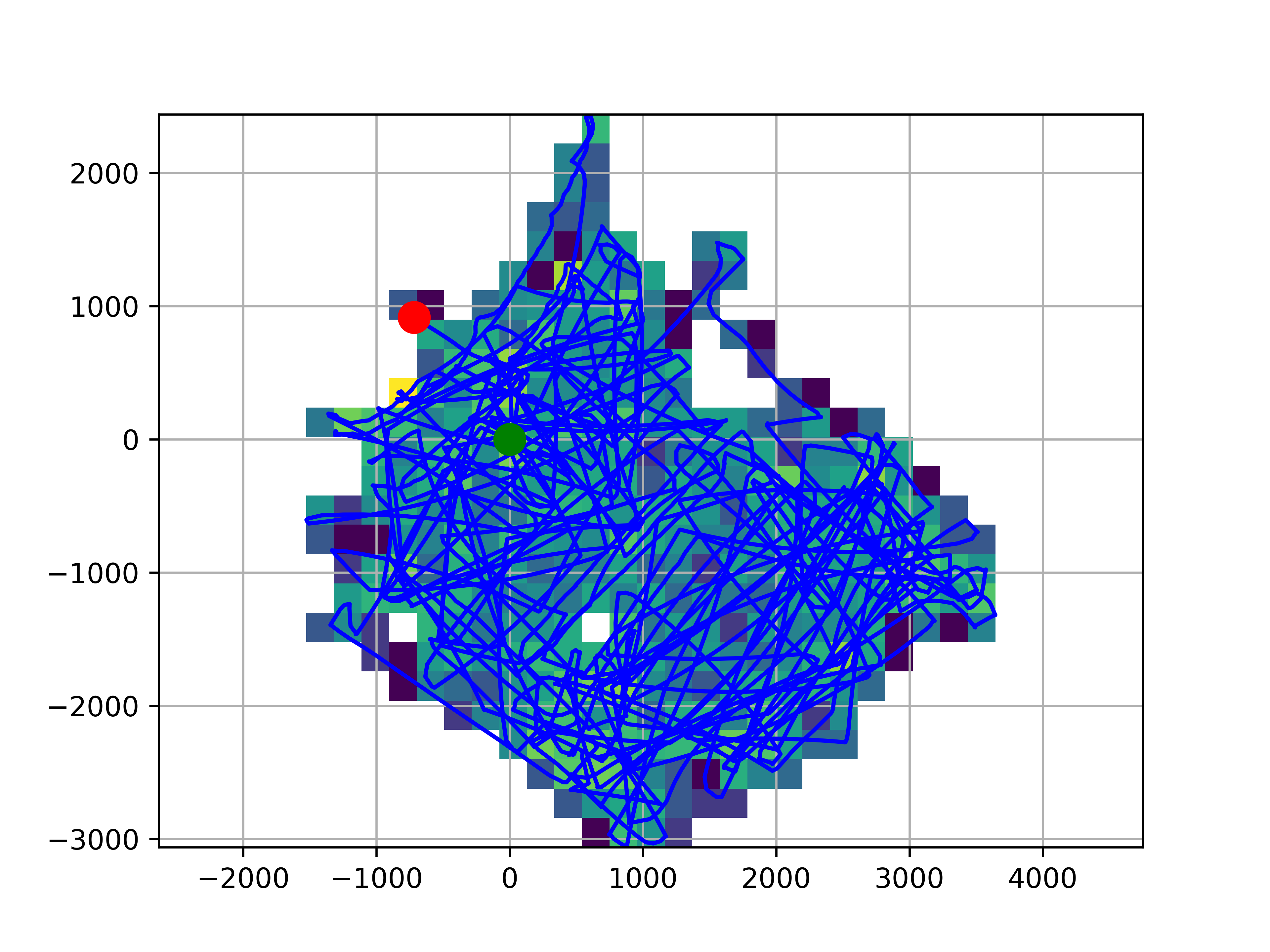

    We're closing the loop!
    While I'm waiting on some stuff to make the Roomba run more stable (guess what, I'ts POWER-ISSUES!), I'm checking off the next thing on my to-do list. That's charting Roomba's travels post-process. And look at the results!:
    Raw:
    Post-Processed:
    I already had a python script running as a daemon on a raspberry pi. This listens to published events and data on the MQTT-broker (running on Home Assistant).
    There are two important events to listen to: start-run & end-run.
    Then there are two data-streams. 1 pose-data calculated real-time by the Roomba. This has X,Y coordinates that are used for a live map.
    2. Raw data containing motorencoder data, real-world yaw by the MPU (for now) and stuff like light-bumpers for wall detection. These values are recorded to a logfile, later used in post-process.
    The positional data is used as a first approximation. The starting & ending position is both on the charging dock. Same position and same pose. This means a closed loop and therefore a loop closing error to correct.
    The first few positions are used to get a starting angle. The last few positions as a ending angle (as a rolling average).
    As long as the total accumulated drift is less than half a full circle, the difference between starting and ending angle can be linearly "smeared" out over the recorded yaw-values when post-processing.
    The same can be done with starting and ending coordinate.
    Python gives some output:
    start run
    Started mapping run
    end run
    Full run is complete. Save logfile and start postprocess
    2558  lines recorded
    Average opening Theta:  0.00093772
    Average closing Theta:  -0.19936671270879255
    Closing error0.20030443270879256
    Error correction:  7.830509488224884e-05
    dX: 487.2798  dY: -646.4786
     Using both angle and coordinate correction is a bit too much.
    So now I'm experimenting with full angle correction and half of the coordinate correction. We'll see after more runs :)

    Writing live map image to buffer instead of file. Reduces load quite a bit.
    img_buf = io.BytesIO()
    plt.savefig(img_buf, dpi=50, format='png')
    img_buf.seek(0)
    poseLogImageString = img_buf.read()
    poseLogImageByteArray = bytes(poseLogImageString)
    client.publish(MQTT_Config.HA_name + "/camera/" + DeviceName + "_" + DeviceID + "/map",poseLogImageByteArray,0,False)
    img_buf.close()
    It's still not fast enough for a real live feed though. Other small changes I made are: using "zorder" to make sure the scatter plot with dots is on top. Changing the size of the dots with s=120 and setting the resolution for both live-map and post-process-map with "dpi".
    Updated python script is uploaded.
    I guess, now it's time to do the deep dive into the accuracy of the positional data...
  • Logs and maps (part 5)
    Simon Jansen09/03/2022 at 10:22 0 comments
    Quick update: better live mapping:
    I noticed the live mapping would slow down and fail. This was because of the way I used the scatter plot function. I added a new layer with just one dot for each value.
    Now I clear the plot and map out the complete path it took with a red dot on its last position. This works much better.
    Updated python script is uploaded to files.
