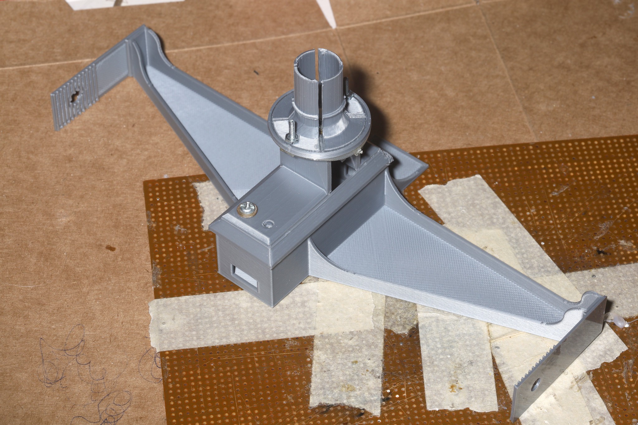

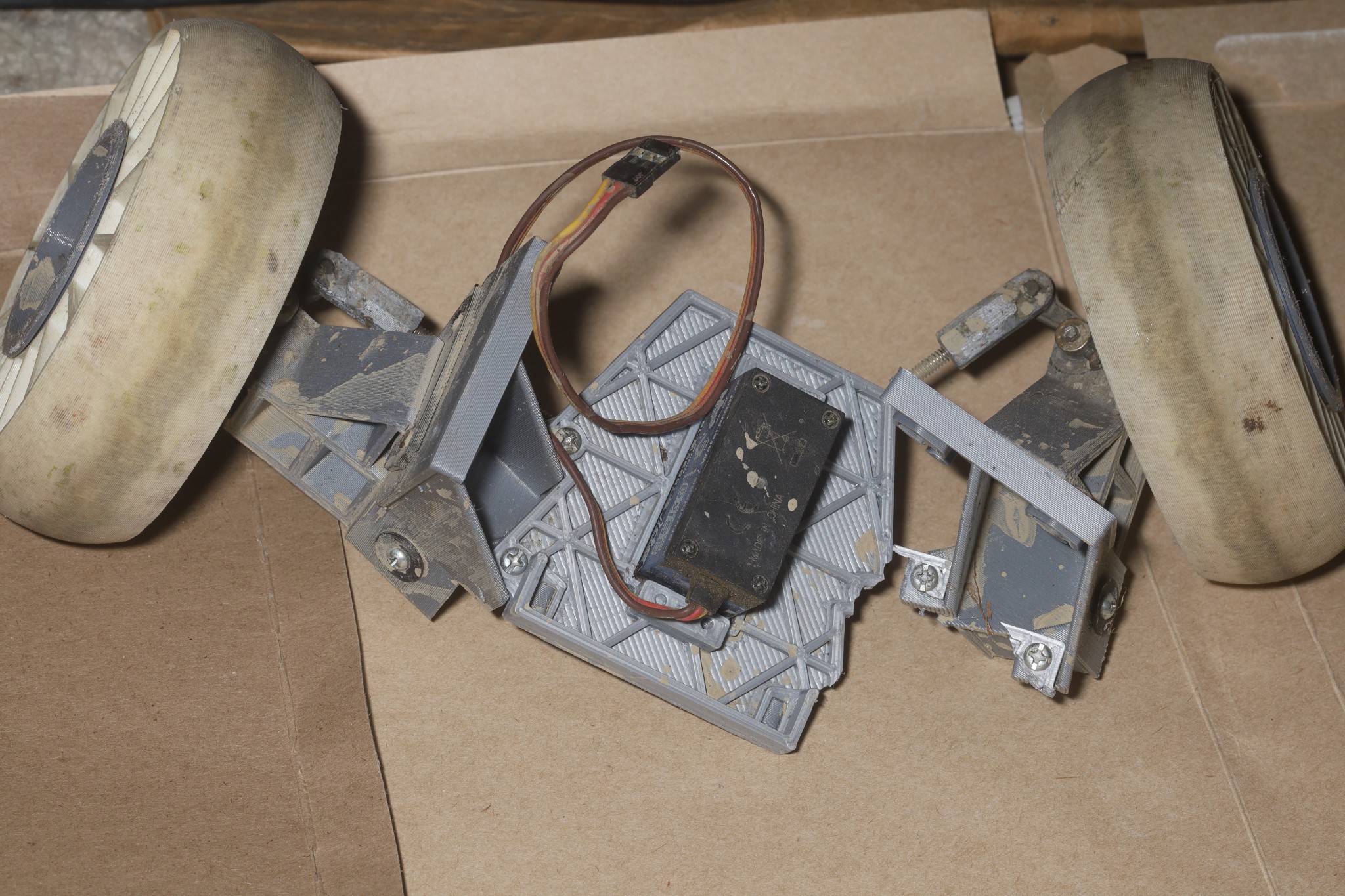

Steering knuckles:
These have to match the wheel base, to achieve ackerman steering.  Lions use
Jazrider Aluminum Front Steering Knuckle Upright For Tamiya RC CW01/Lunch Box
from fleebay & size the wheel base to within 1" of a lunchbox.
Steering servo:
The lion kingdom uses discontinued trackstar brushless servos with servo savers.  Brushless is required to get any life out of them.

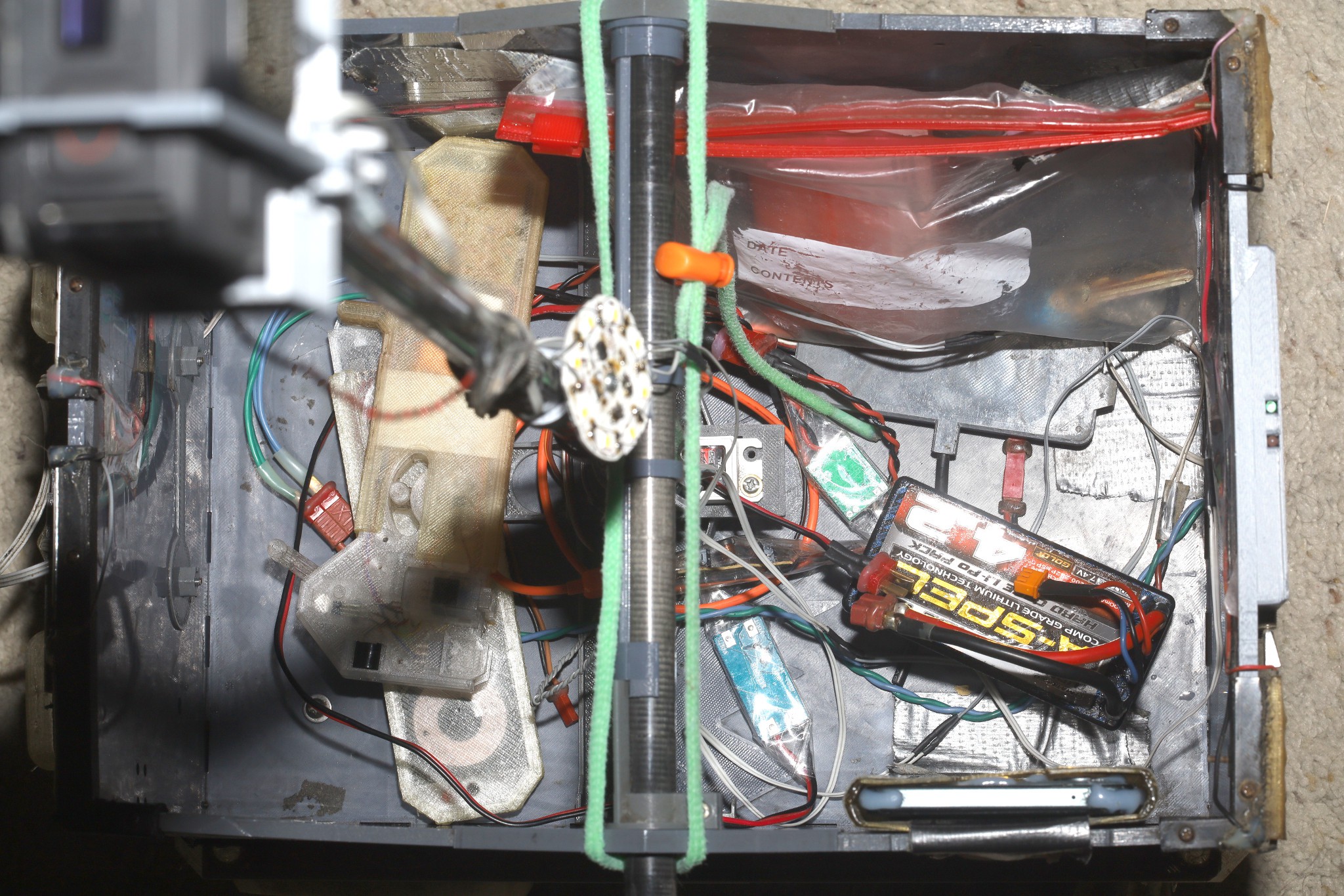

The 3 mane components are the steering module, traction module, & the coroplastic container.  They're held together by  aluminum angle rods.
The tires are 3D printed out of TPU for a lot less money than Chinese ones.

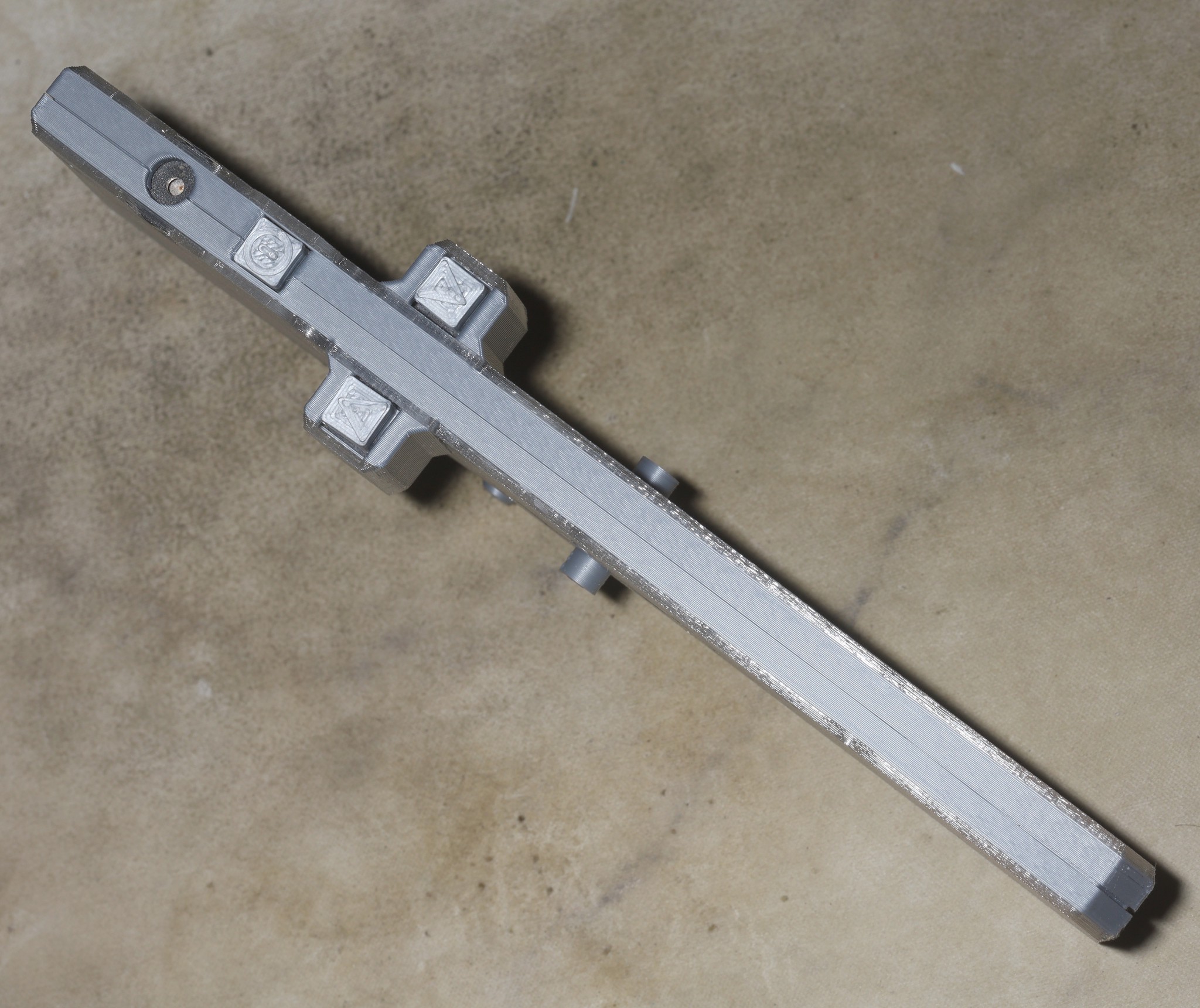

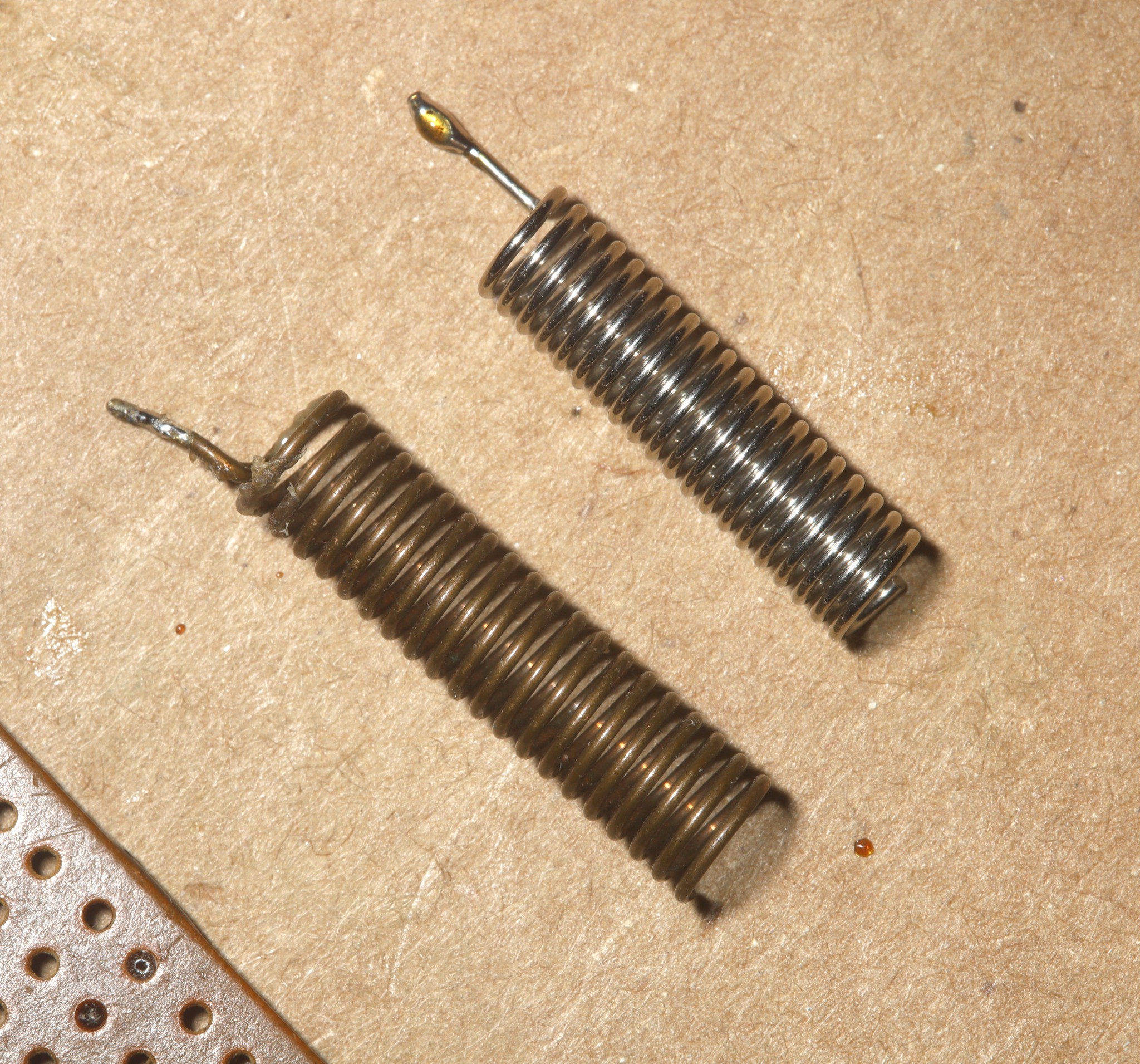

The final mechanical piece is the paw controller.  It uses springs from ball point pens.

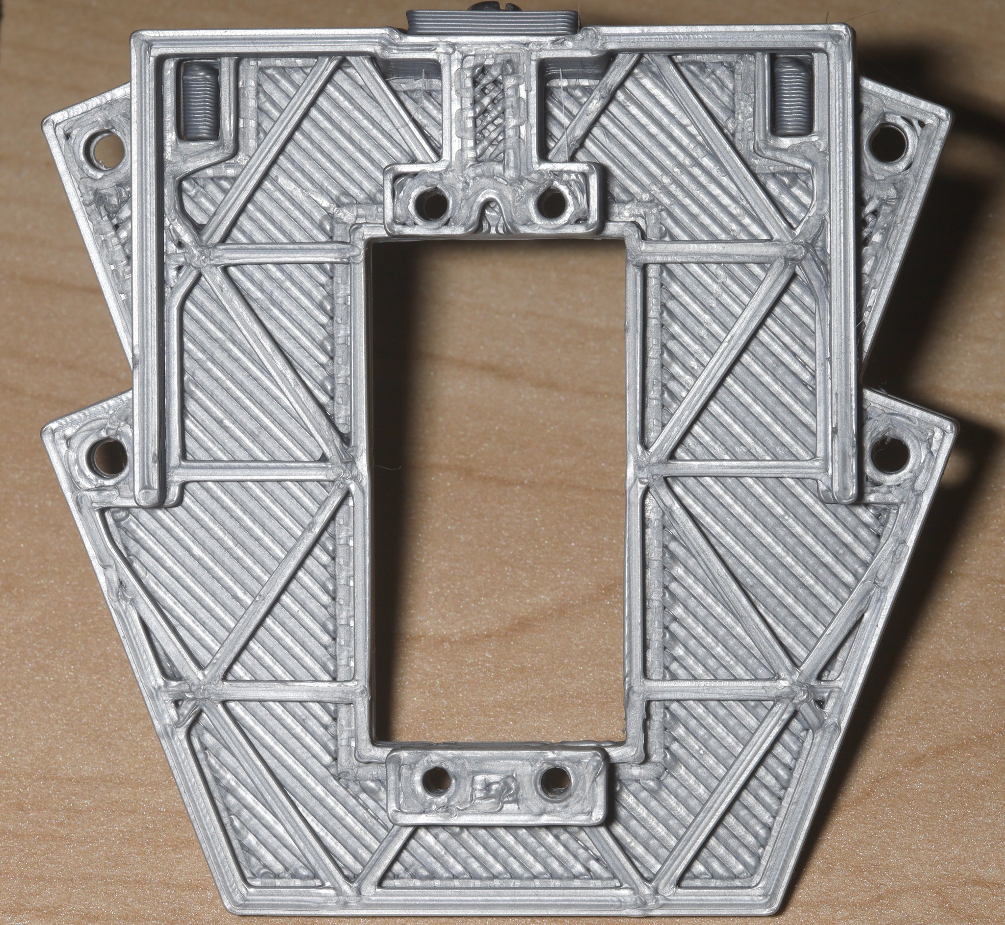

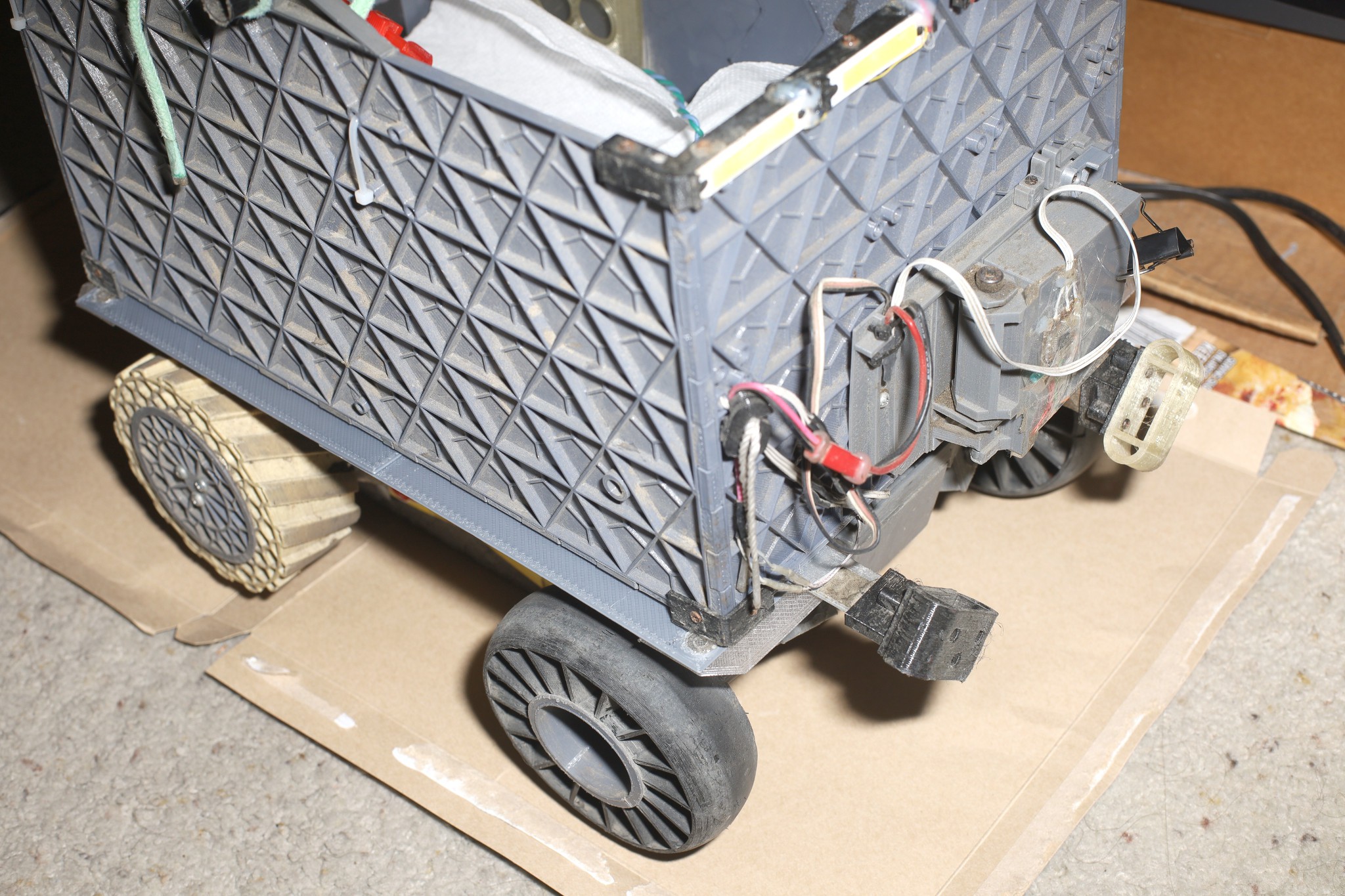

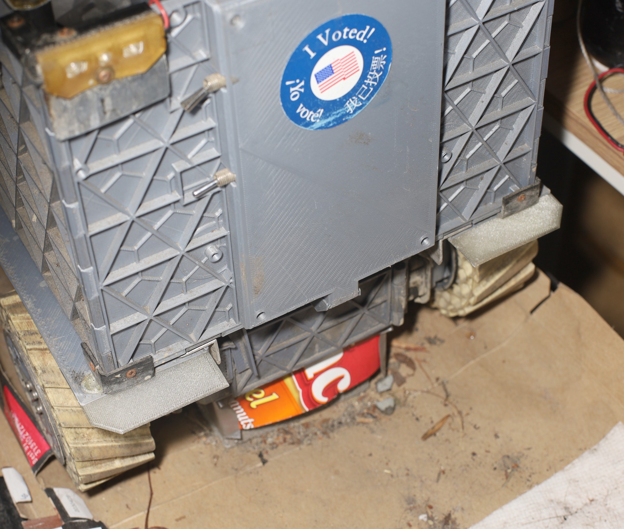

    Another smashed steering panel from bashing into a curb resulted in another upgrade to the steering panel.  No more glue required.

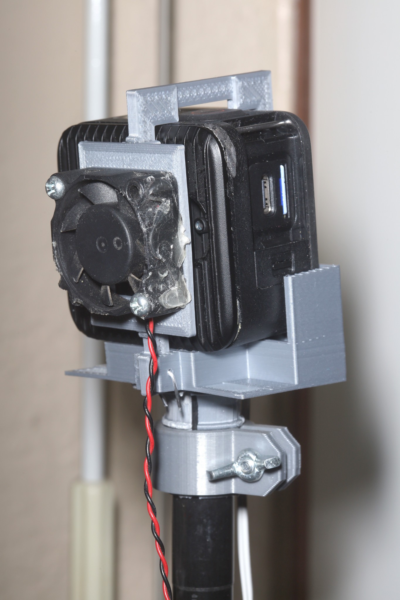

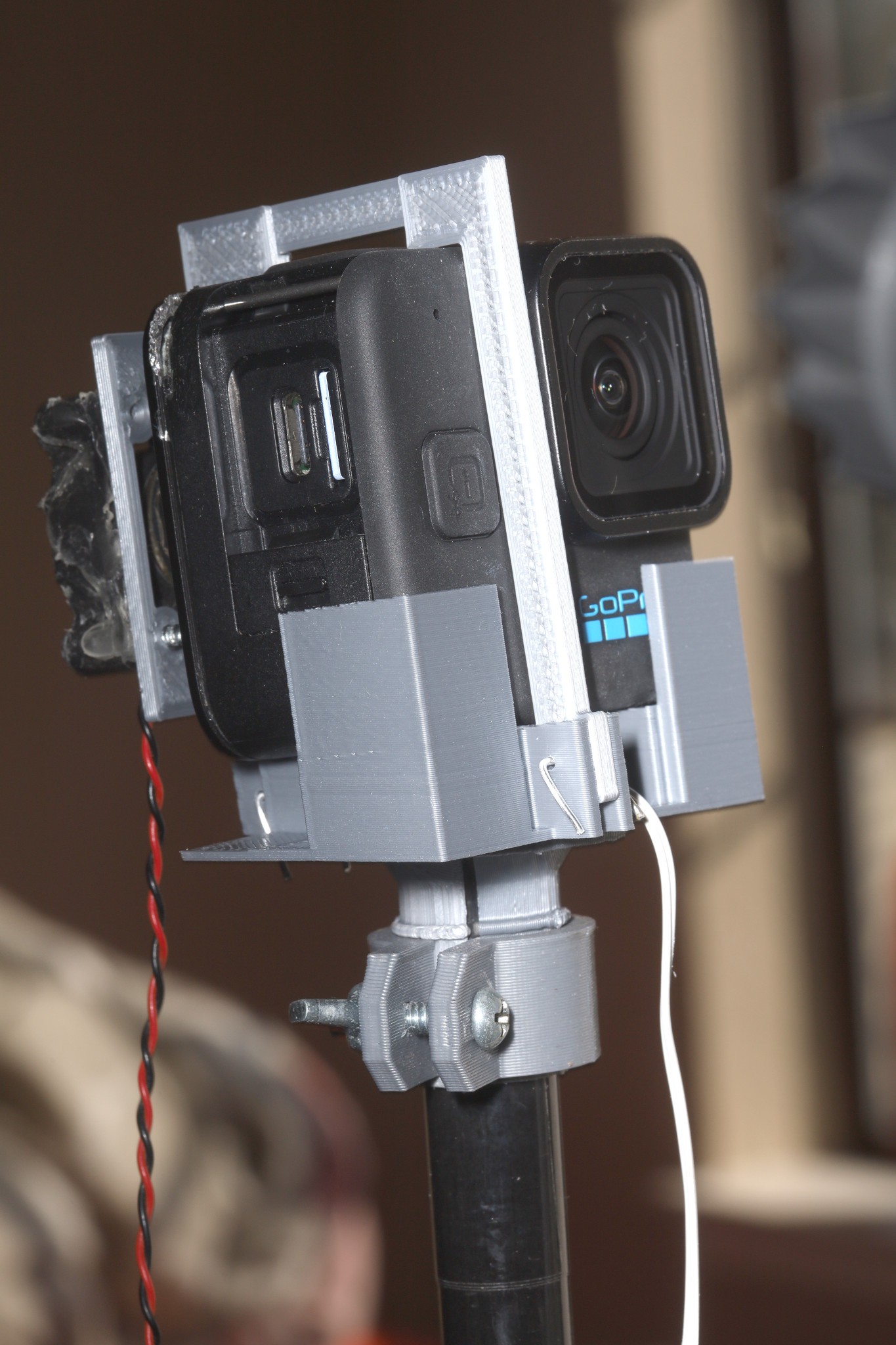

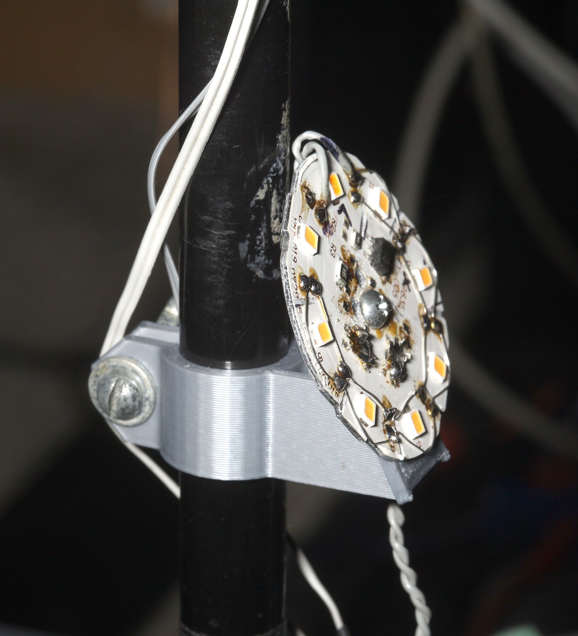

    Camera pole got a new light which improved the rare night footage.  Discovered gopro 24fps does better in the dark than the timelapse modes.

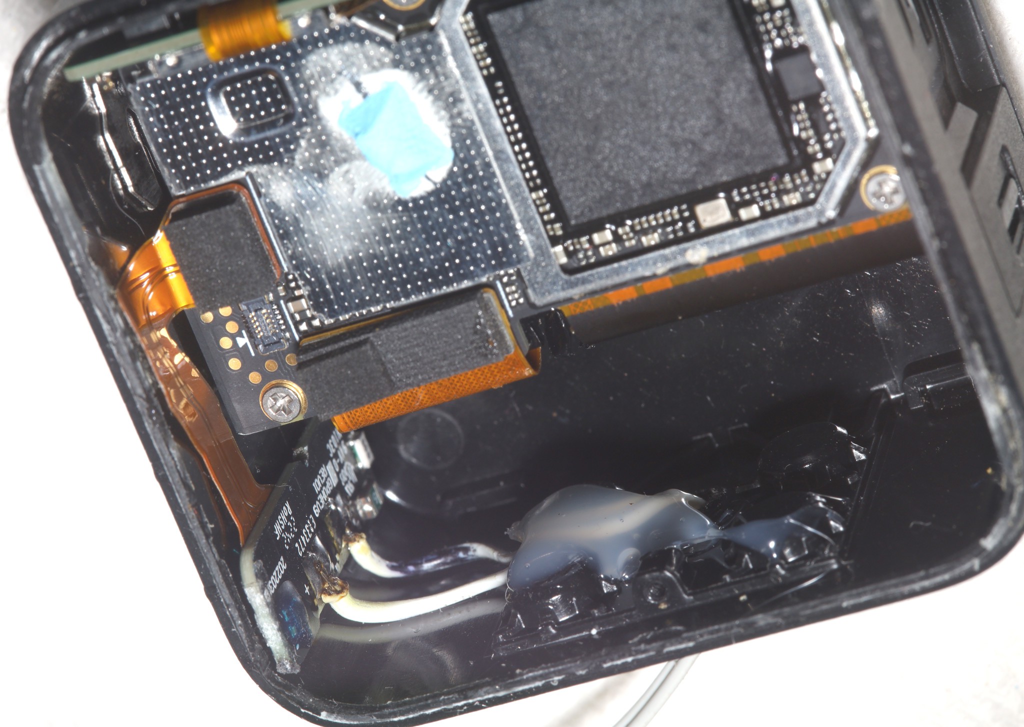

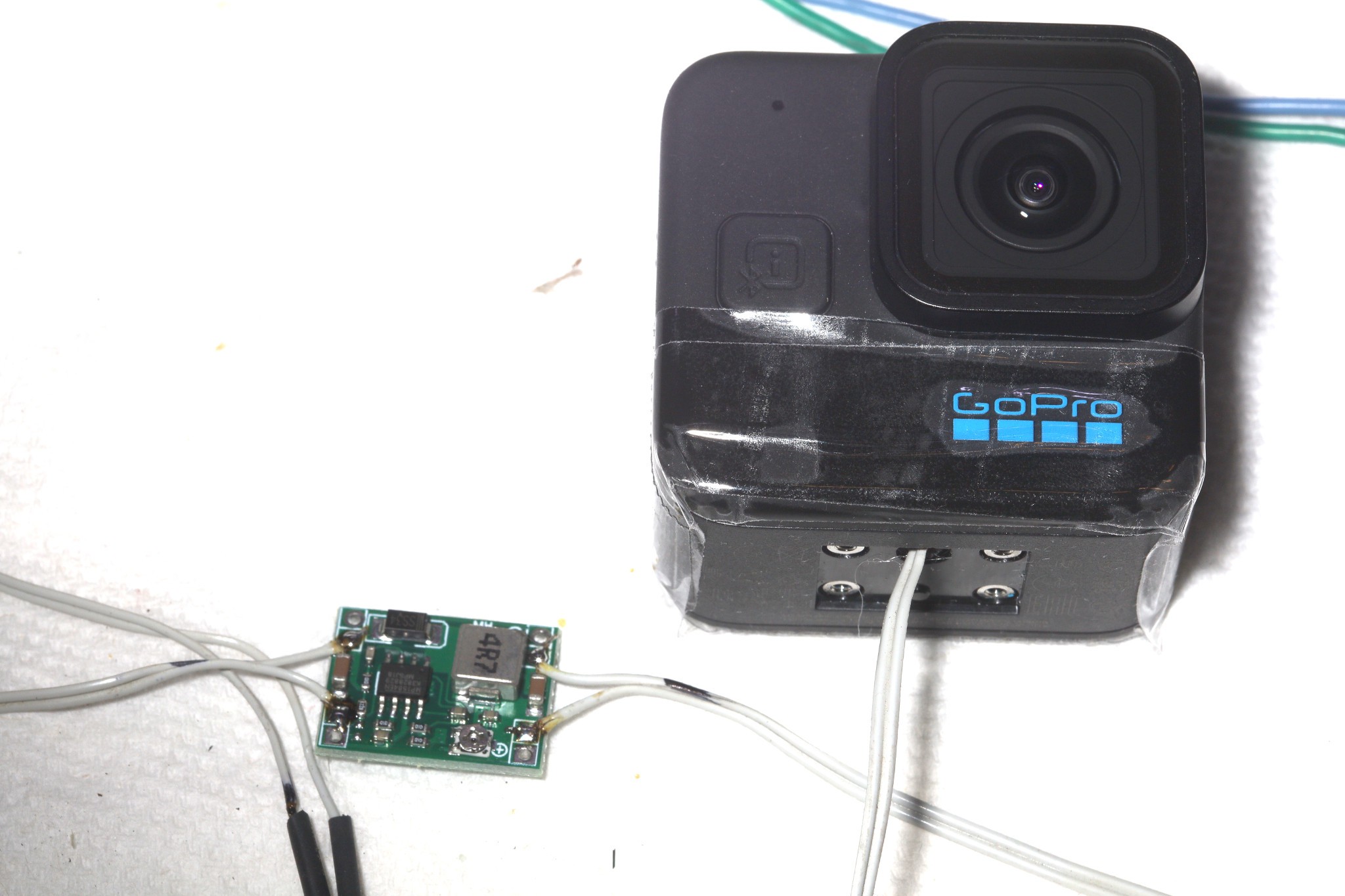

    A lot of effort went into a gopro11 enclosure with active cooling & dummy battery.
    The dummy battery required permanently breaking the heat sink off so it can never be used again without the enclosure.
    https://hackaday.io/project/203999-dummy-battery-for-gopro-11-mini

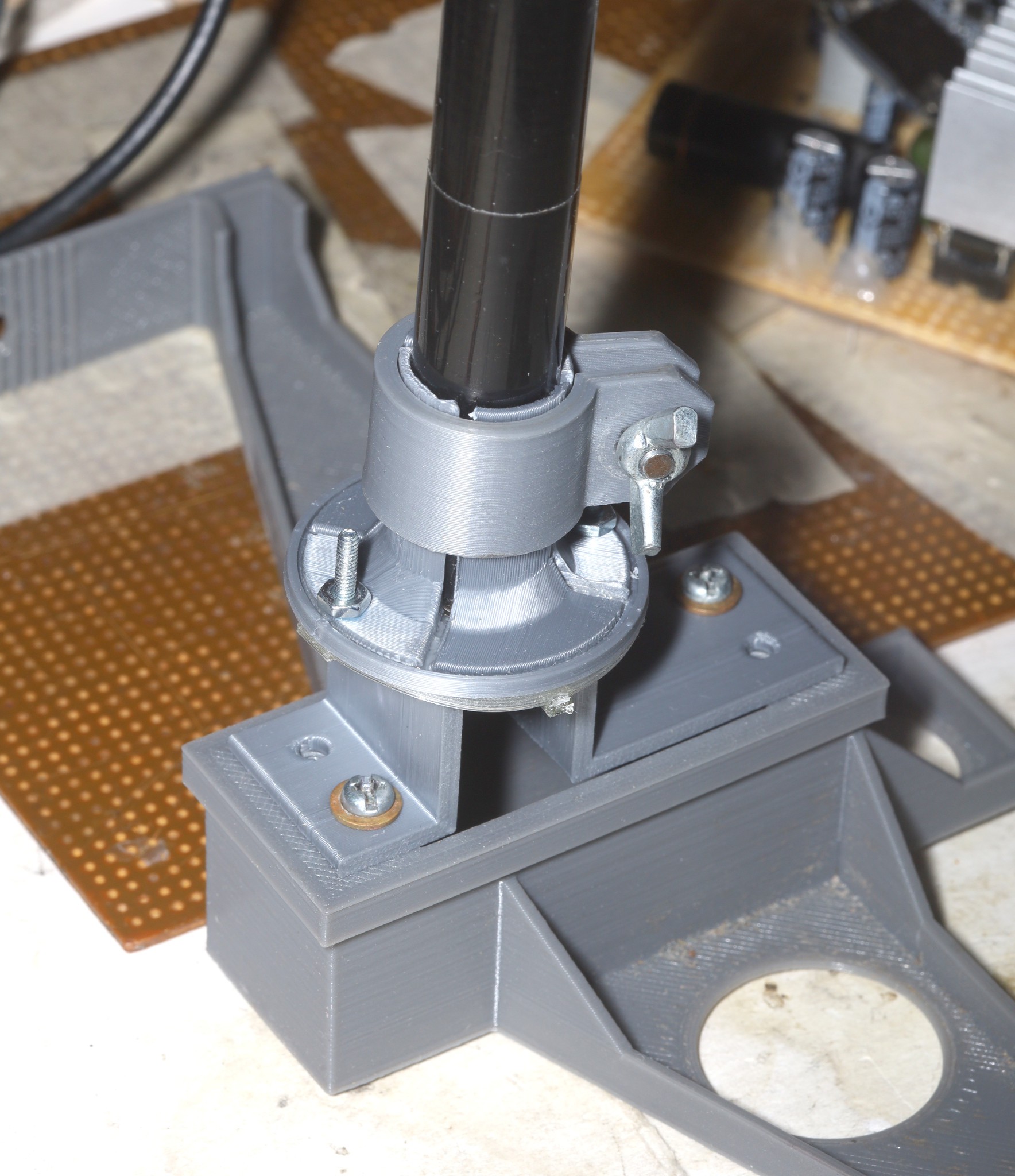

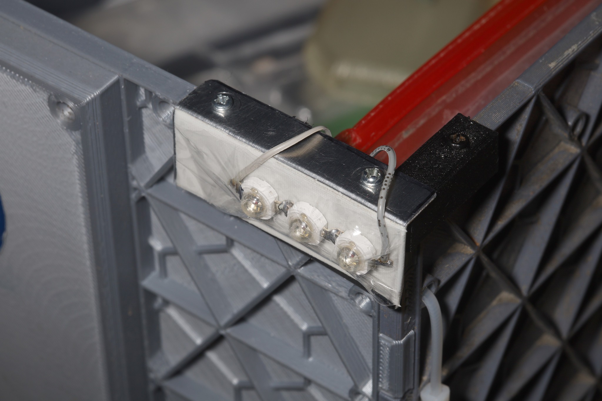

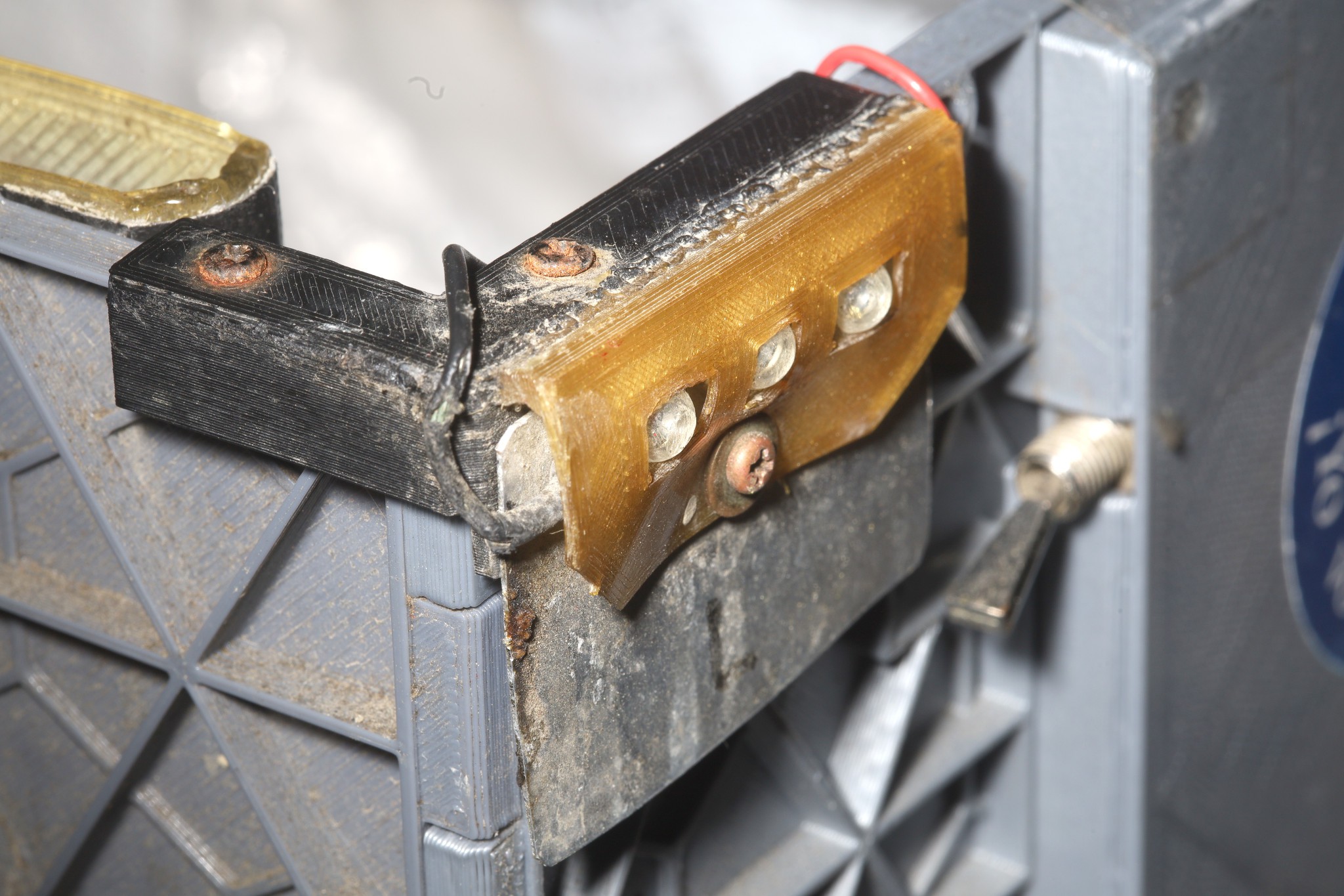

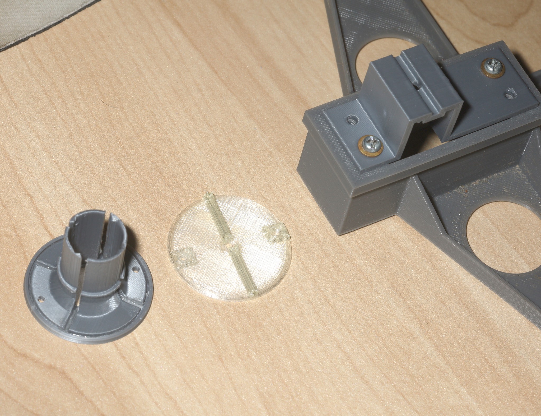

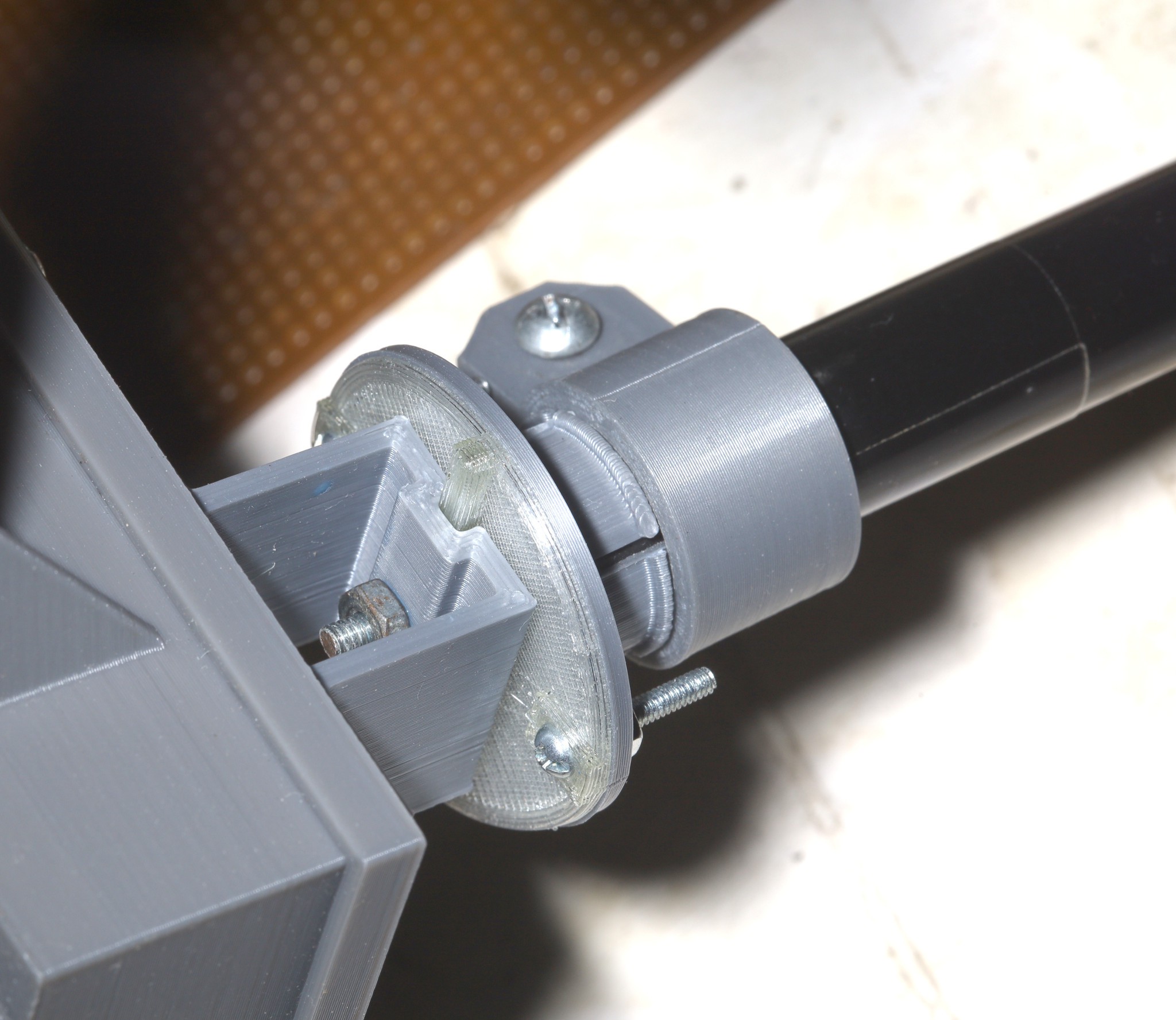

    The well yellowed TPU tail lights were replaced by a new scotch wrapped aluminum angle, with stainless screws.  The new problem is the scotch trapping dirt between the LEDs & adhesive tape, but the contact is about as bad as the TPU.  This is going to be a wear item.

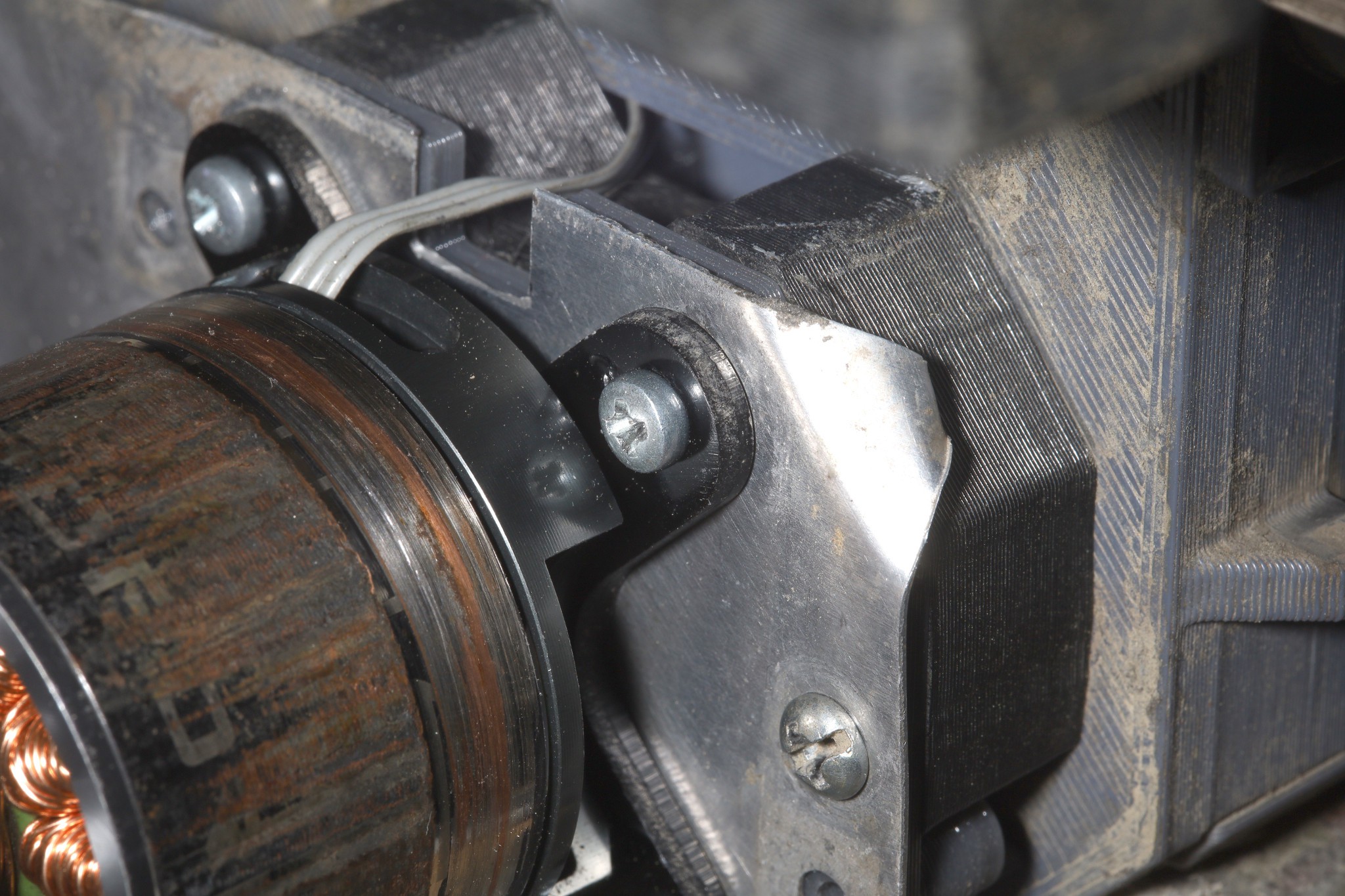

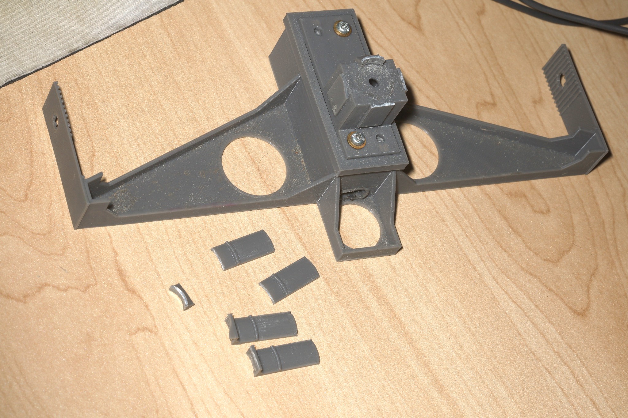

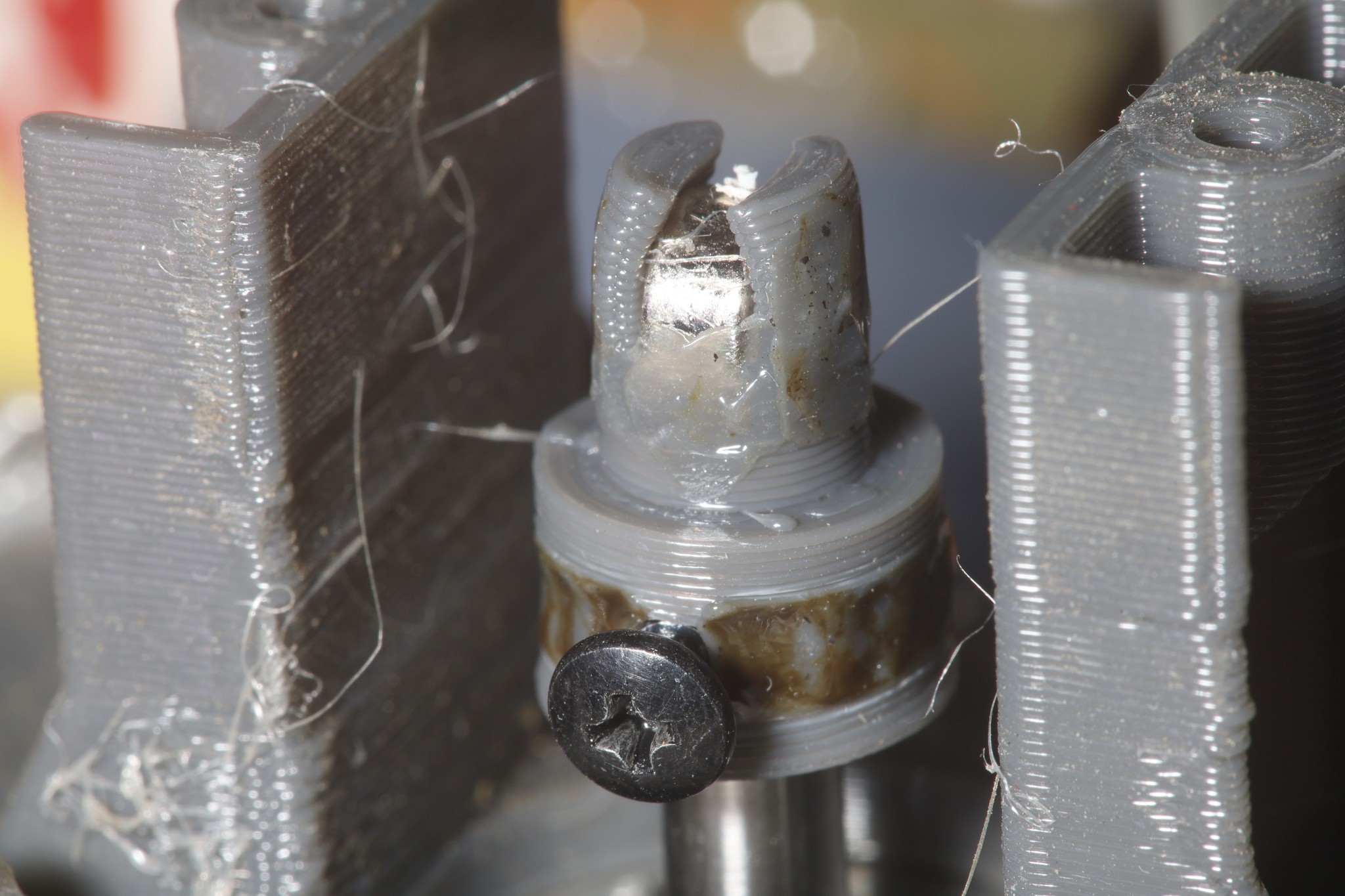

    A protracted battle with the motors seizing resulted in a new magnet holder & farsteners upgraded from 2-56 to M3.  The tiny fraction of a mm seemed to fix the seizing, but the real problem is depending on an encoder which is aligned by a load bearing structure.  Studies into Clarke & Park transforms showed there's still no way to time the commutations at low speed without a dedicated encoder.  A gear driven encoder would be the next step, but would suffer from different types of errors.
    The firmware got a new feature which allows a seized motor to be deactivated.  That way it can drive on just 1 motor or be pulled in leash mode by an animal.

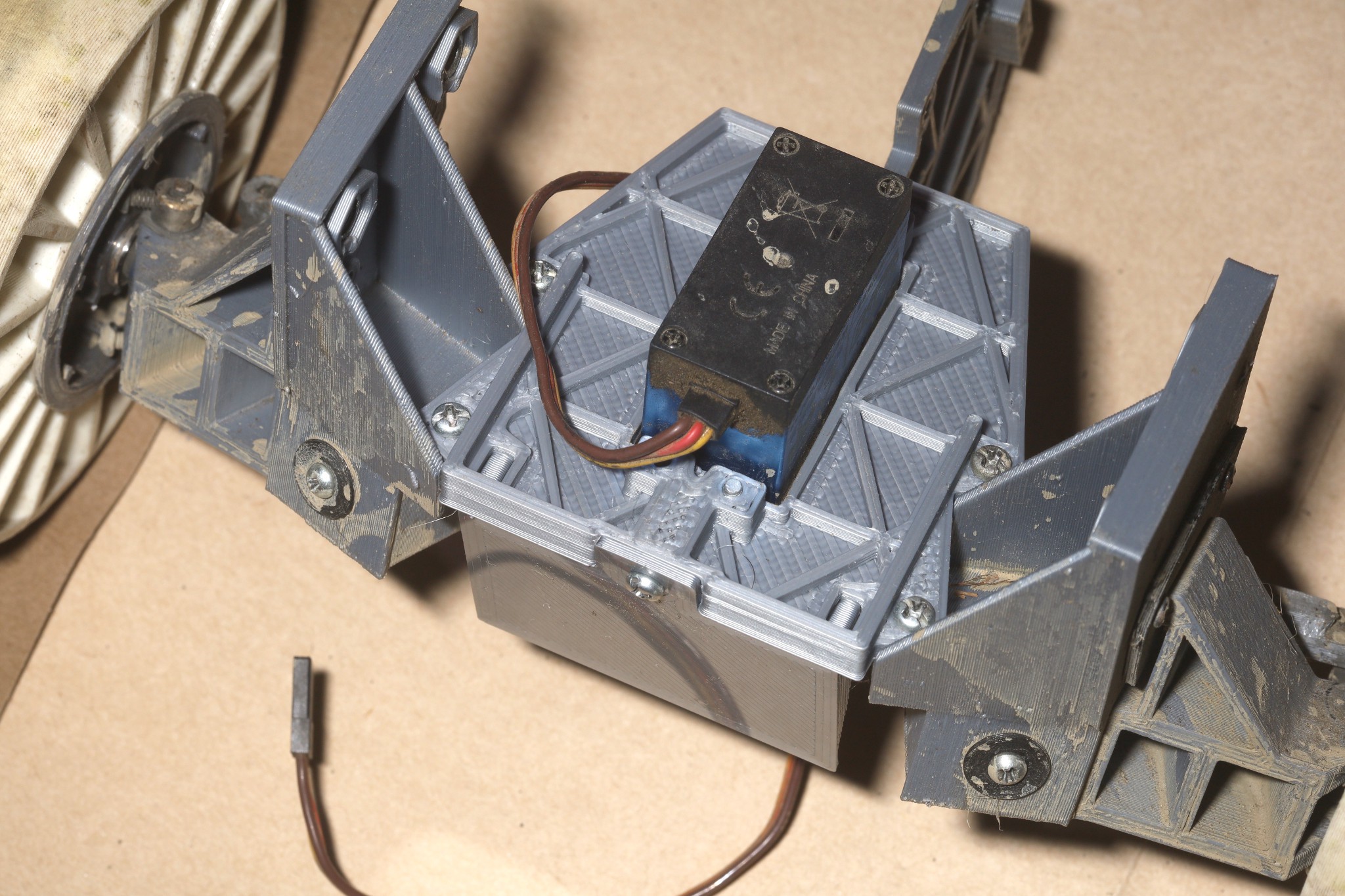

    More breaks in the dummy servo resulted in another adapter, which once again requires the camera pole to be removed to access the dummy servo.
    Then it got further refinement to try to reduce the mangling of food.

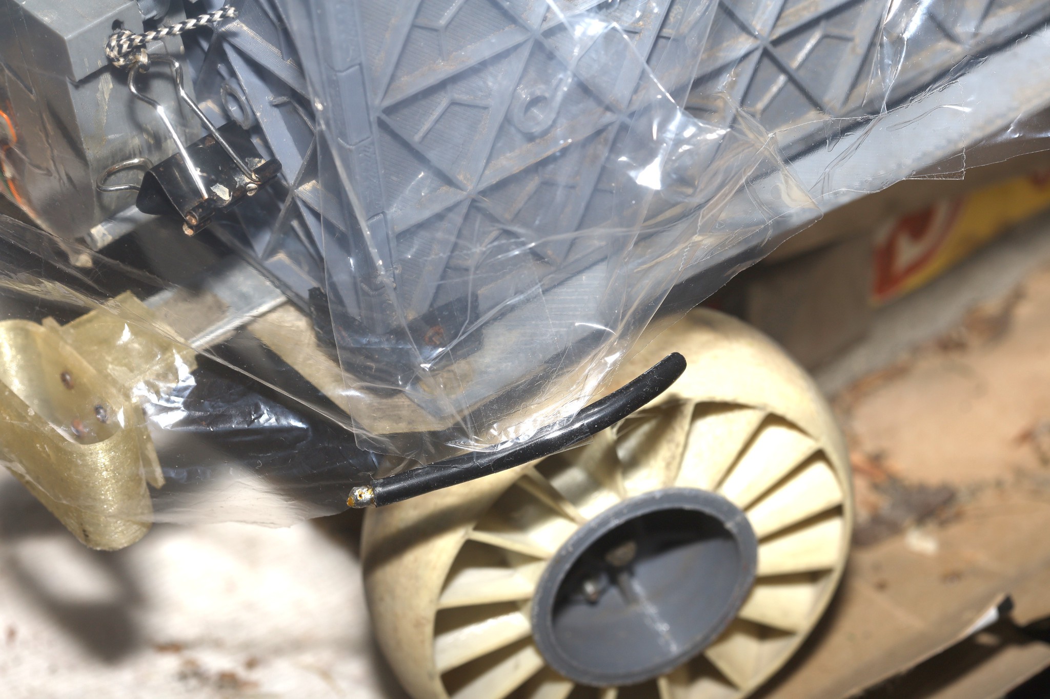

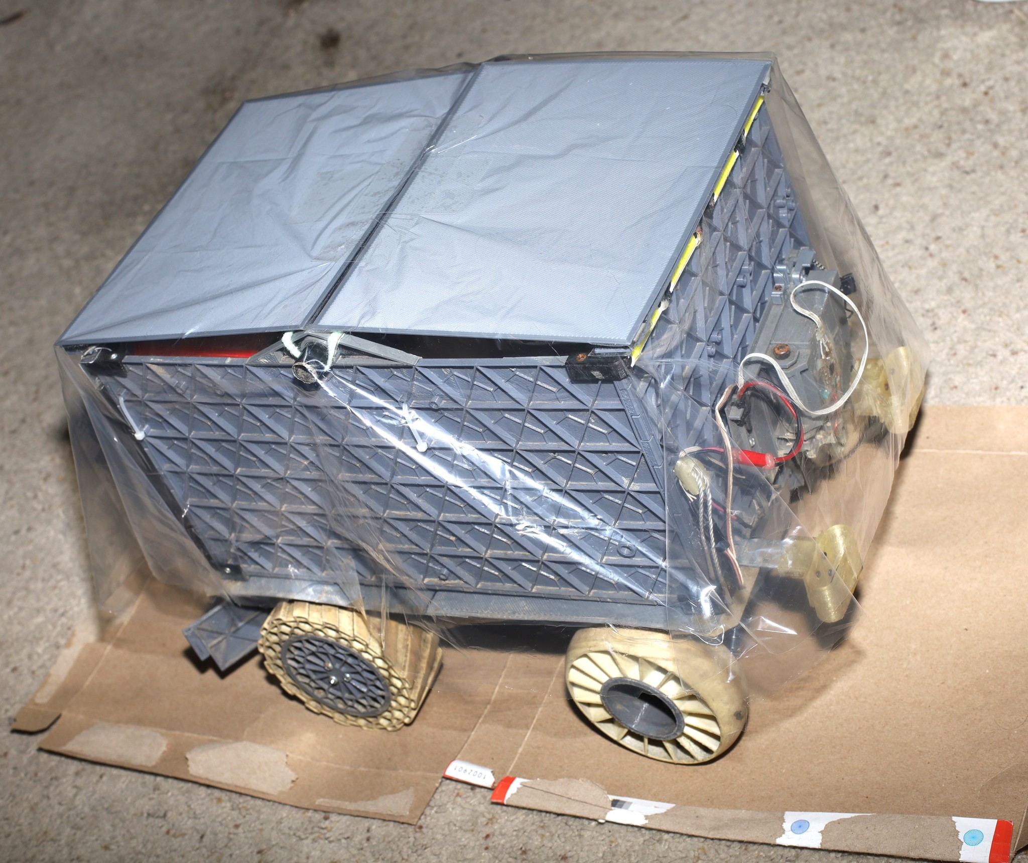

    Efforts at waterproofing had little success.  The latest idea was an elaborate combination of PLA panels, velcro, & recycled poncho plastic which completely covered it.  This was quite cumbersome, bulky, & prone to getting blown away.

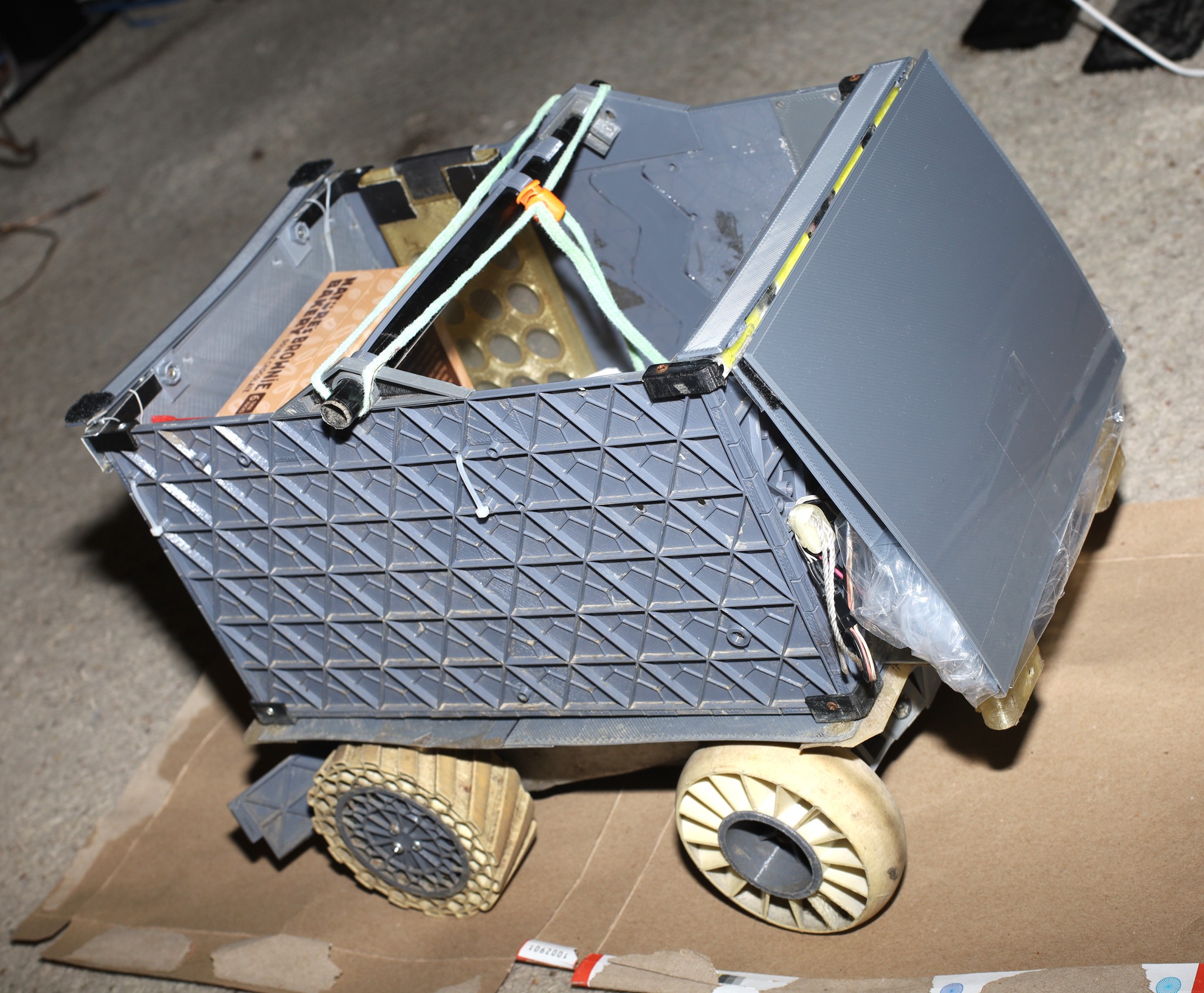

    Ongoing efforts with splash boards were keeping the container relatively clean, but not very dry.  The mane problem has been keeping them from getting smashed during backflips & side swipes.  They've been trending towards a pure TPU construction.

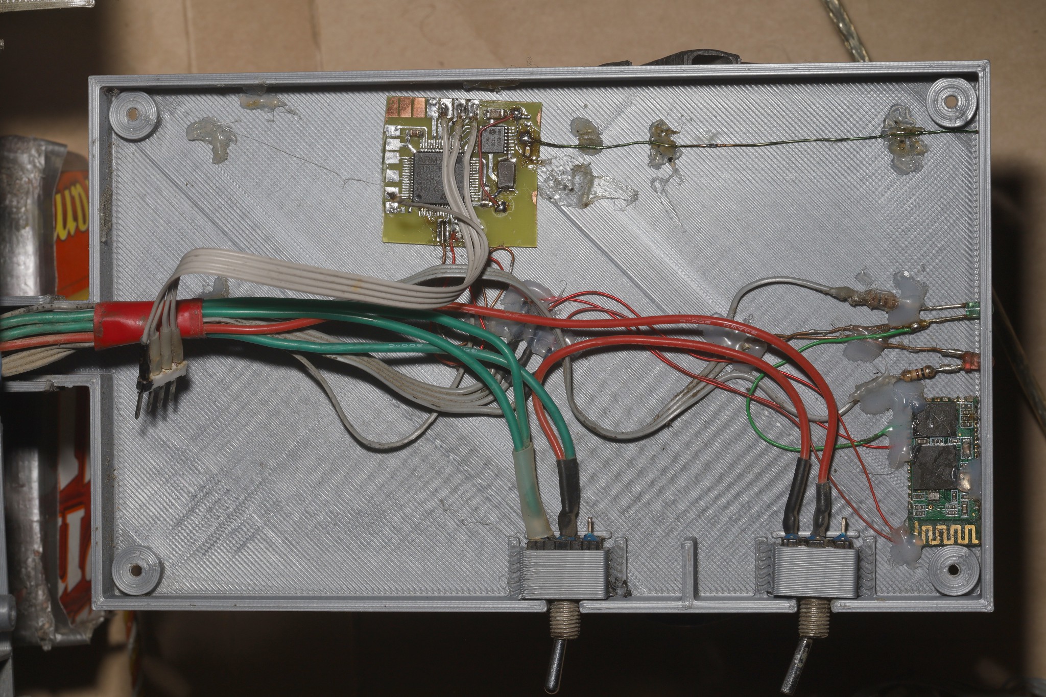

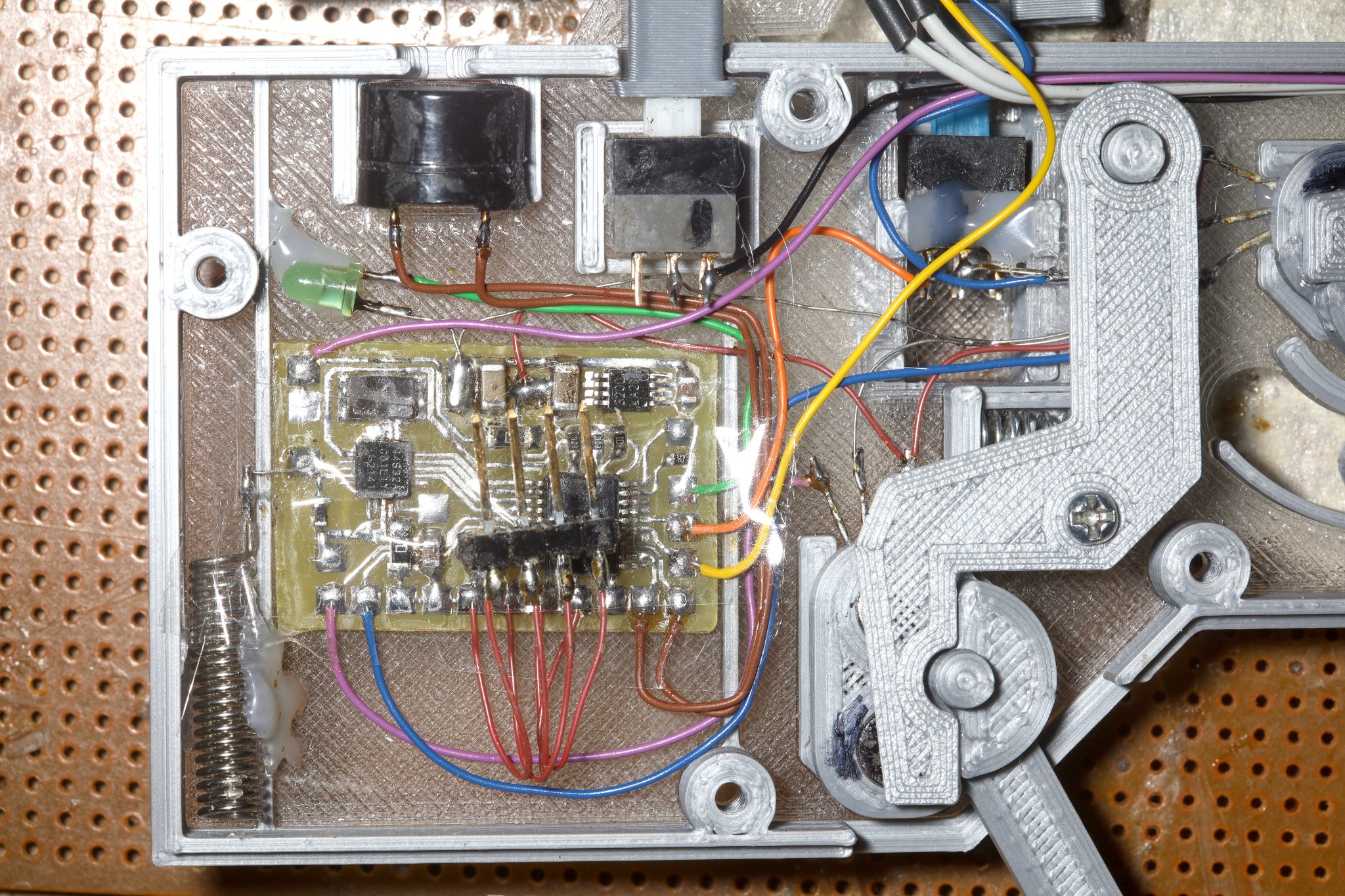

    Split the circuit into a charger board & radio board.
    A mix of clear & grey filament made an appealing case, but any future clear PLA was abandoned.  It lead to overheating in sunlight & was too brittle.

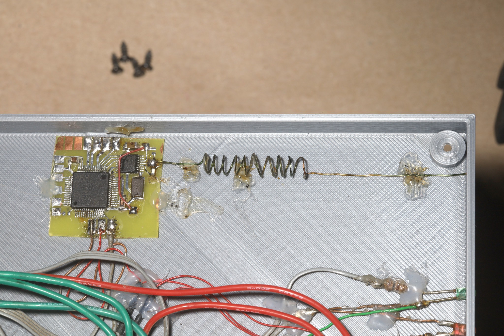

    It was found that the antenna could be optimized by measuring the transmitter current.  The receiver & antennas could be adjusted by plugging them into the transmitter.  The density of a coil changes the electrical length independent of the length of the wire.  This led to some antenna changes which made the biggest improvement in range but also increased battery usage.
    There was an effort to improve the reception by oversampling the PWM signal in a really fast microcontroller.  It didn't make any obvious improvement that would justify the cost, because the hardware already does schmidt triggering.

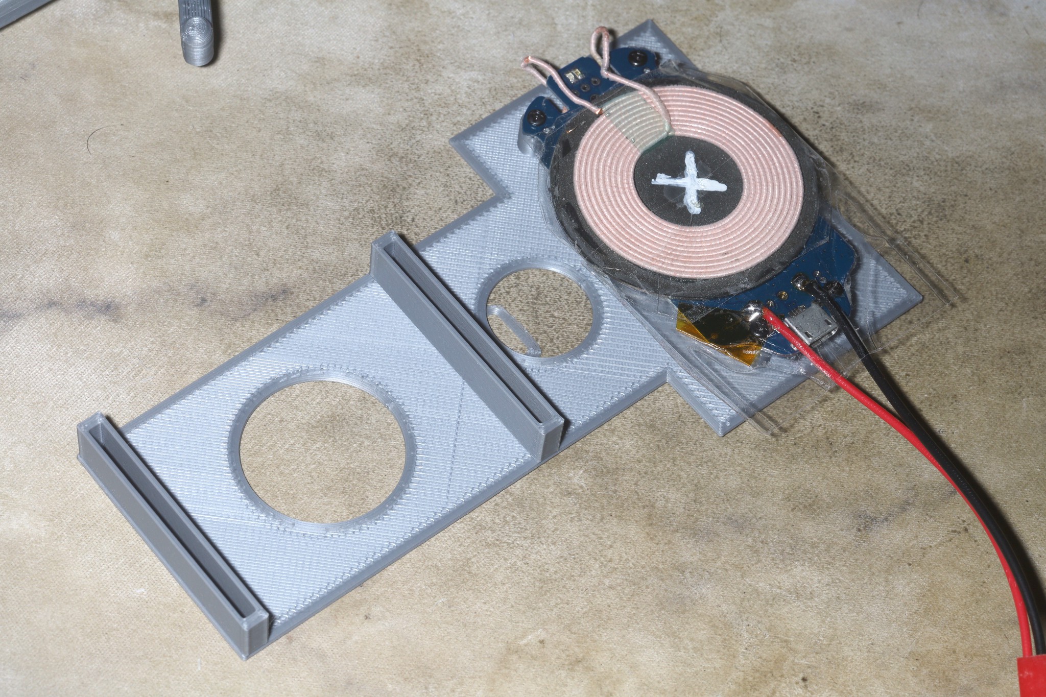

  • Charging stand upgrades
    lion mclionhead01/21/2023 at 23:06 0 comments

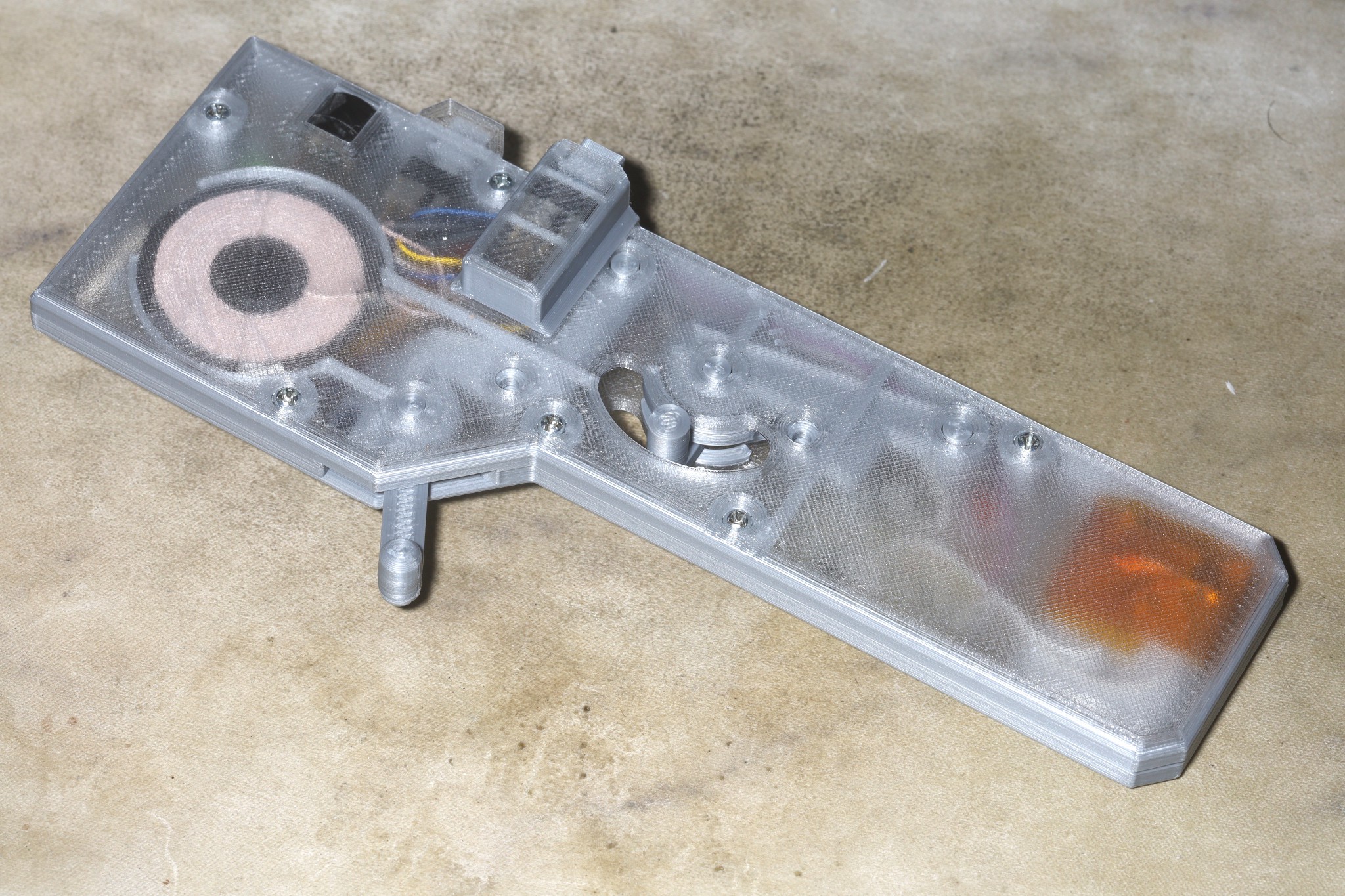

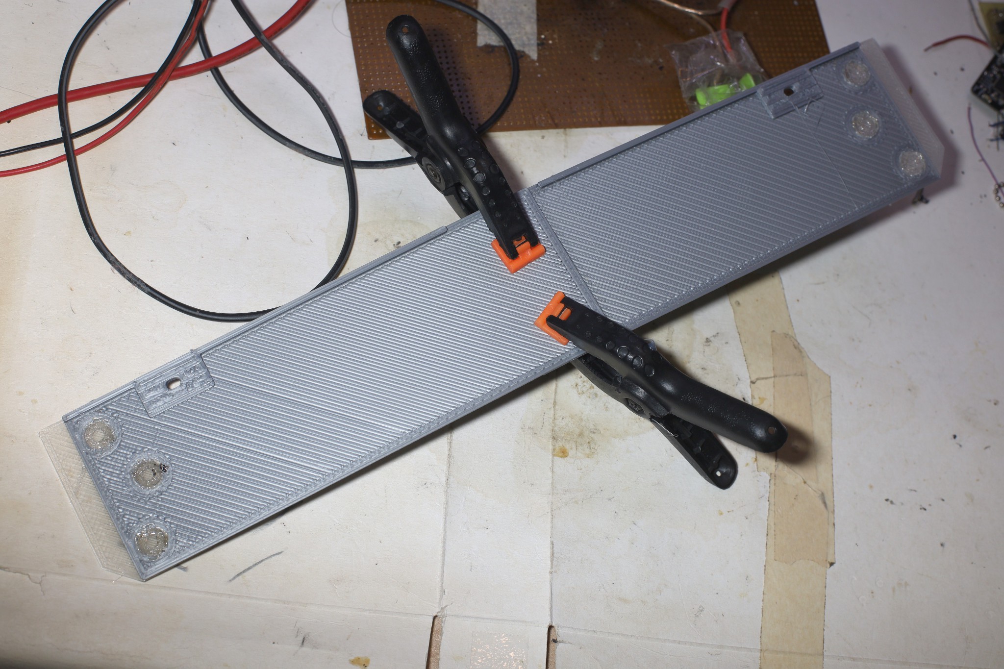

    To make the controller waterproof, the TPU sock eventually had to be permanent which meant updating the charging stand.
    In this process, the charging inductor cracked.  Those are really fragile.  If the enclosure is too small or you try pulling it out when any PLA rivets are holding it in, it's going to crack.
    The temptation is to press it when grabbing the charger. The problem is the new design fully exposes the inductor & nothing supports it in the middle. Below it is an air gap followed by the circuit board. At least Walmart has qi chargers locally at a reasonable price. The easiest solution is to not PLA rivet it & have some kind of foam press it out from the circuit board. It has a packing tape cover which could also prevent it from rotating.
    The lion kingdom's PLA riveting skills have improved to melting it with a brushing motion of the soldering iron rather than keeping the soldering iron stationary. This keeps it from sticking to the soldering iron. Then use the mark 1 lion paw to press it in position before it cools.
    With the sock now permanent, it would have to be translucent to see the charging LED.
    Translucent TPU & PLA entered the printer.  The decision was made to retire orange PLA & hard black TPU.   TPU is manely used for tires.  The hard variant had very little use.
    Panels which dominate lion prints come out a lot clearer than walls.  It not obvious whether the filament came wet from China.
    The charging LED is now visible.

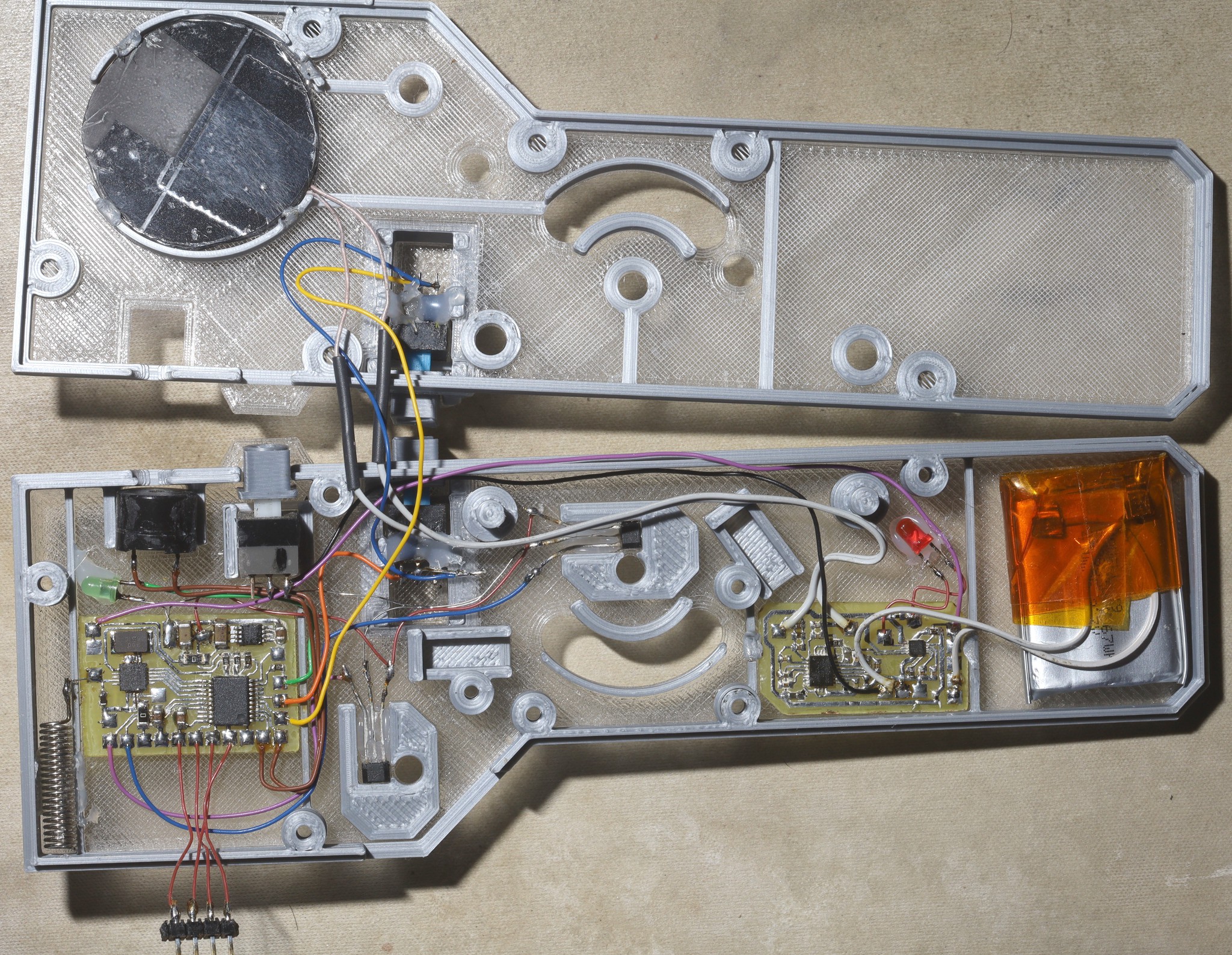

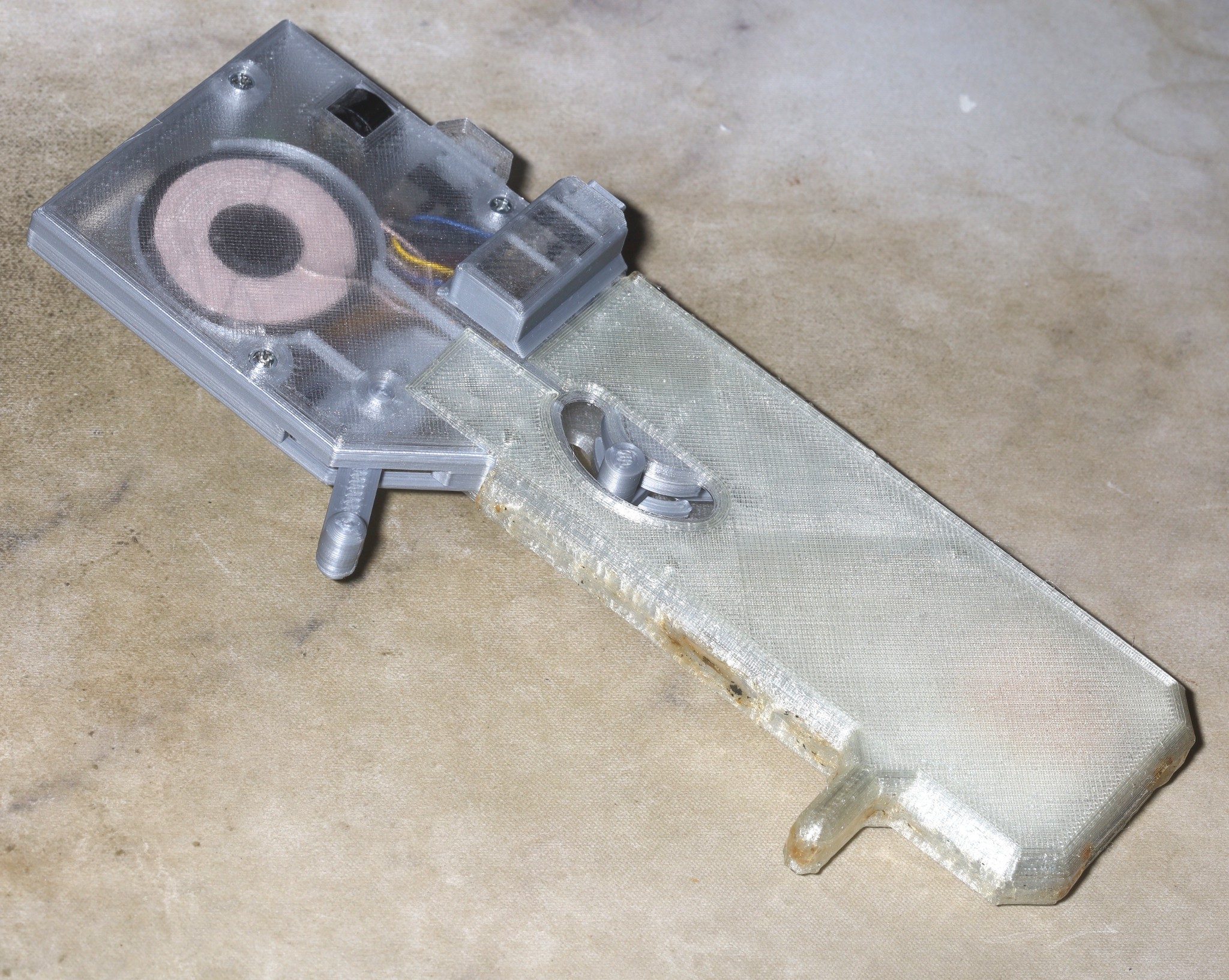

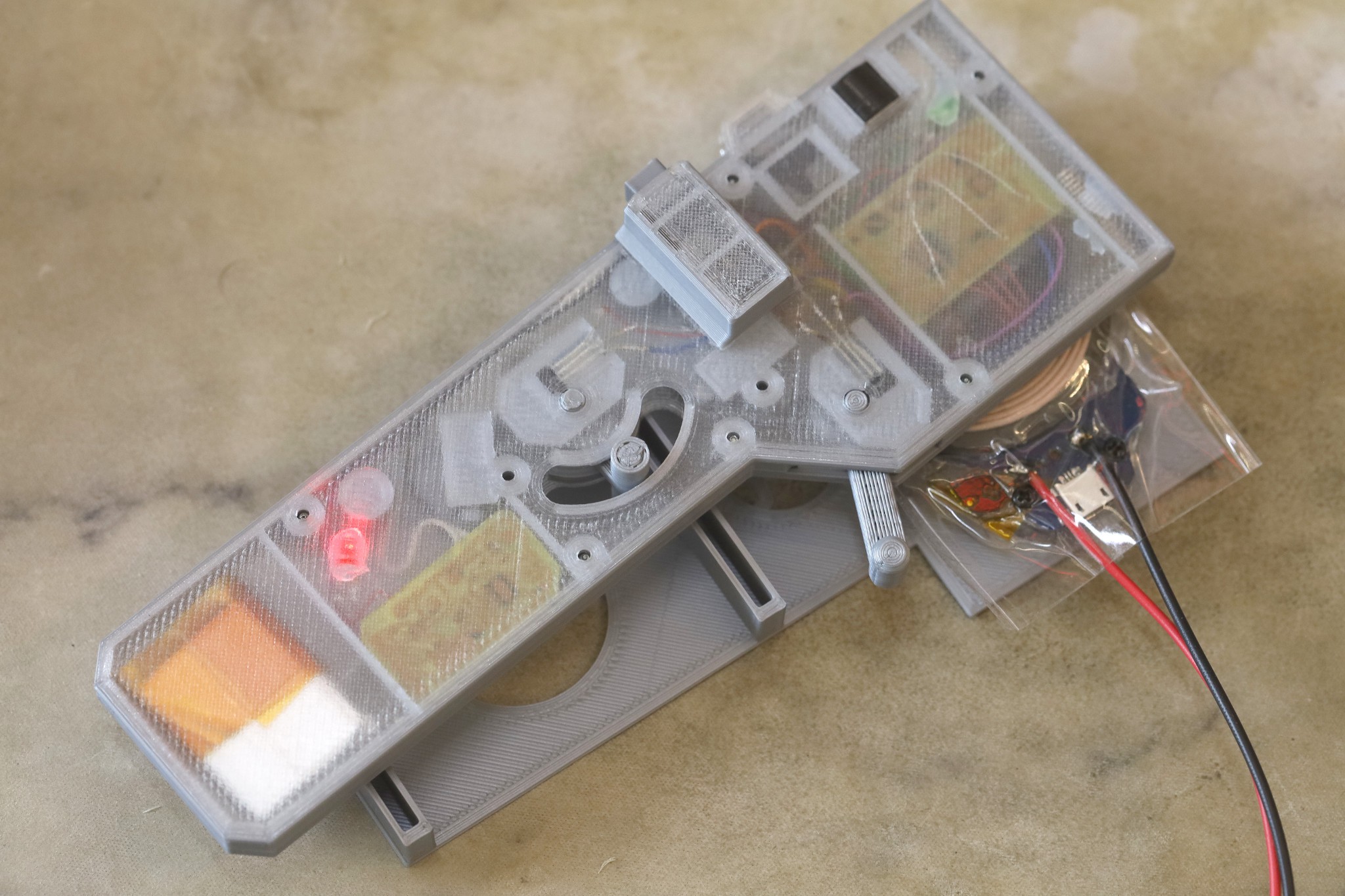

  • New remote
    lion mclionhead01/10/2023 at 07:30 0 comments
    The mane desires in a new remote were improved water resistance & replacing all the hot snot with PLA welding.
    PLA welding was a successful failure.  1 switch still ended up needing hot snot.  The best way to install the hall effect sensors was still to put a dab of hot snot down 1st, then press the hall effect sensor on, then flatten the dab. A dab of grease on the hall effect sensors still made a big improvement. Grease should not go anywhere else as it causes sticking.  The only reason the joysticks get stuck is friction with the hot snot & grease.
    A new trick with PLA welding was to melt the PLA with the iron but use the mark 1 lion paw to press it down. It adheres to the iron but not to the lion paw.
    In the interest of water resistance, a sock covers the entire handle.  The sock is removed for charging.  If there's any evidence of how bad lions are at 3D concepts, it took a long time to realize the finger grip could be part of the sock. It actually holds water but doesn't have enough friction to stay on.
    The mane problem is the welds don't go as deep as hoped. No point in using orange PLA if the sock is covering it. Low cost TPU is quite good for covers like this. Trying to stretch it over the steering stick was hopeless, so it got a cutout.
    The leading idea to get it to stay on is taping the PLA to make it thicker.  Other ideas are to print ridges inside the sock or make the sock narrower at a point.  The problem with making the sock expand around the enclosure is welding the sock requires fitting it around the enclosure 1st.  It would need a blank smaller than the enclosure just for welding.

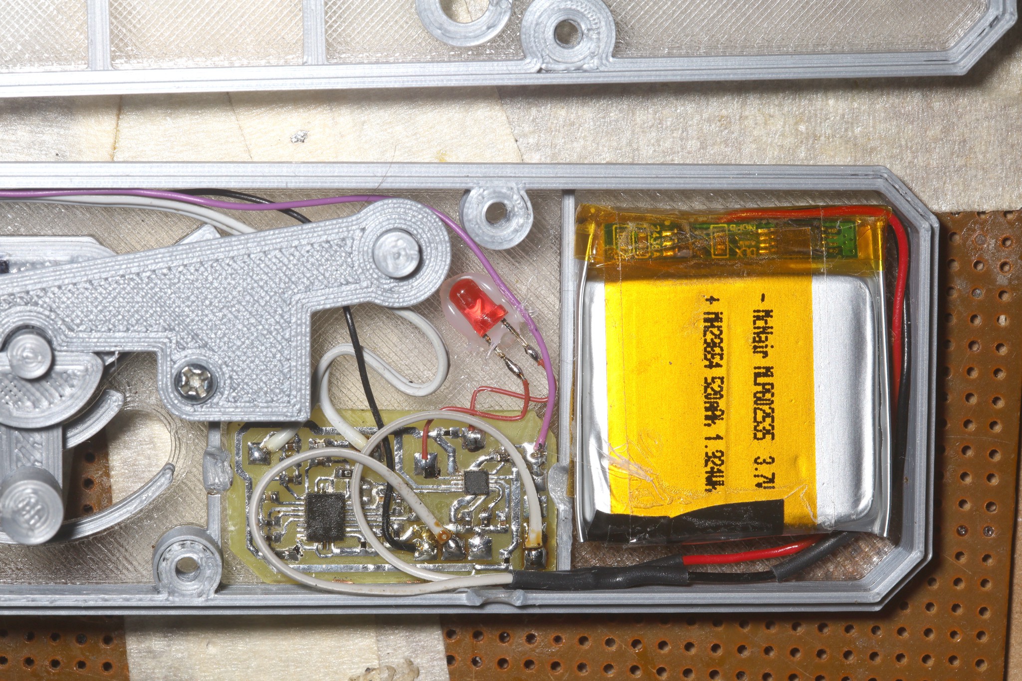

    Power consumption was 50mA, so a 260mAh battery is only going to last 4 hours on a good day. It needs the 400mAh battery which somehow fit in the last one. The 260mAh required a lot of coaxing to fit in there. If the radio constantly transmits, it burns 120mA. The transmit duty cycle is 5ms on & 35ms off. The PIC has to run at full speed for the sounds.
    There's 1 heroic bodge wire to connect MISO to the radio. Despite every effort, the radio failed to initialize without several power cycles. The datasheet says Vdd needs 1ms ramp time. The LP2989 has a 5ms ramp when probed.
    Merely cleaning the flux got it to start despite the LP2989 issue. Getting rid of 100uF of capacitance didn't do anything.
    After fighting to get the sock over the LEDs, it was decided to put the LEDs inside the case & hot snot the LED holes shut. With orange PLA, the red charging LED shows nicely but the green transmitting LED is barely visible. Transparent PLA would be ideal, but there's a real need for white PLA for an LED diffuser. Nylon paper might work as an LED diffuser, which would make transparent PLA the better deal for fabrication.  LEDs that diffuse through the enclosure should be a bigger part of all designs.
    The hall effect sensors are 1.3mV/G so they never saturate.  There is a desire to make the handle narrower to compensate for the sock size.  The steering lever should be either square or longer to compensate for the sock.

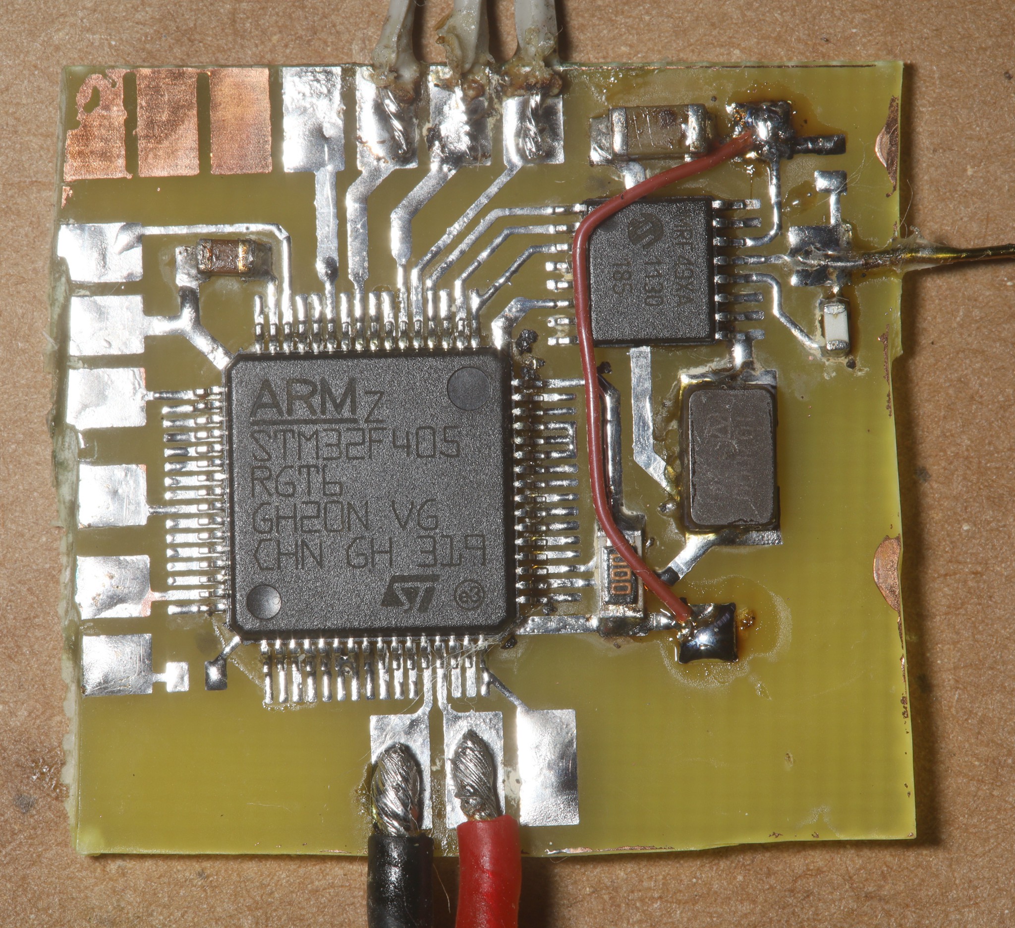

  • Secrets of the Si4463
    lion mclionhead01/09/2023 at 19:38 0 comments
    It was finally time to build a new remote control for better water resistance.  Sadly, the original Si4421 radios were discontinued & problems with the RFX1010 burned the last 2 of those chips.  It was never figured out why those failed after working in 2 boards.  The Si4463 promised to make enough power to not need a front end & has a higher bandwidth.
    The Si4463 is 10 years old but already a beast.  It requires all 4 SPI pins.  It uses the MISO pin for flow control. While the datasheets show the pinout & an example schematic, they don't have any inductor values.
    The new dance is separate RX & TX antenna pins.  For transmitting, a simple 100nH seemed to do the job.  There's no plan to use it for receiving.
     The register descriptions in the datasheets seem to be obsolete.  All the register values are documented by the Wireless Development Suite (WDS3).  Bringing it up is not possible from the datasheets.  The WDS3 has a radio configuration application which generates all the required code.
    You have to export a custom project after setting all the configuration bits.  The header file option doesn't work.  The 2 key files it generates are
    src/drivers/radio/Si446x/si446x_patch.h
    src/application/radio_config.h
    The key object is the RADIO_CONFIGURATION_DATA_ARRAY.  It's just an array of packets to send to MOSI with flow control codes.  The 1st byte is a packet size.  Then you send the packet.  Then you poll the CTS register before reading the next packet.
    SPI is MSB 1st.  The datasheet didn't say that.  The flow control procedure is in the radio_comm_SendCmdGetResp function.  Part of the auto generated array is a firmware patch which requires 512 bytes.
    The only requirement for using a UART to modulate the signal is declaring 1 of the GPIOs as an input & selecting Direct TX as the project.  Set the other GPIOS to TRISTATE & they can be connected to ground.  Then send a START_TX with 0 for all the arguments.  That is auto generated in the si446x_start_tx function.
    The other trick is setting the deviation to match the Si4421.  That's how far the carrier shifts above & below the center frequency for modulation.
    For frequency hopping, the channel is sent in the START_TX command, but this is only accurate to 30Hz.  The base frequency is accurate to 1Hz.  The base frequency is set by the RF_FREQ_CONTROL_INTE_8 & RF_MODEM_AFC_LIMITER_1_3 registers.  The channel spacing on the Si4463 is only accurate to 30Hz  while on the Si4421 it was within 10hz.  To save power, use the channel number in the START_TX command.
    The PA power level is 0x7f for full power & 0 for lowest power.
    There is a desire to resend the packet multiple times per hop, but this requires a receiver change.  Without a unique ID in each resend, it seems to screw up the hop timing.
    The ramp up time for transmitting is under 1ms on the Si4463, which greatly reduces the amount of current required from the 5ms required by the Si4421.

    Startup difficulties
    The mane reason it won't start up is the ramp time for Vdd being too high.  The easiest solution is to connect SDN & drive it high until Vdd is done.  Thus, it takes 5 digital signals to start up.
